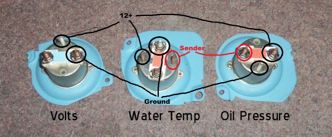

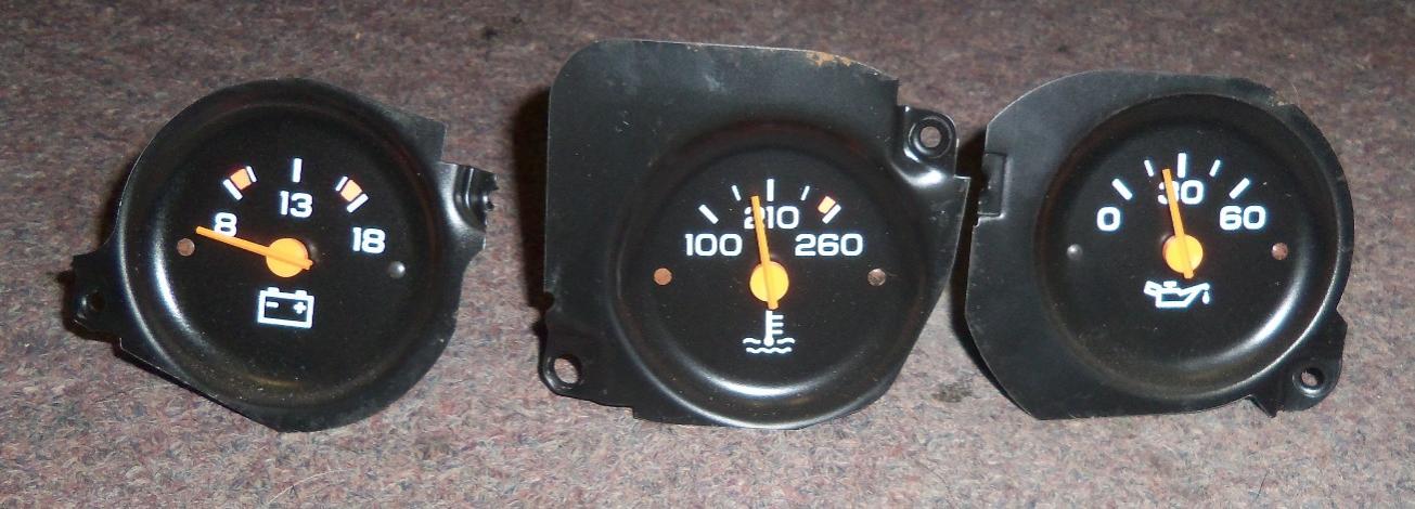

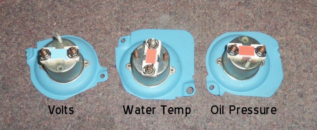

Thinking more along the lines of Pops making Test Clusters.... I was going to do that with this 81 Cluster I have. I then realized, if we knew the pin out on the gauges, we can test each gauge manually with alligator clips under the hood. Positive to +, Negative to -, and the the sender wire to a good known sending unit. All my gauges work in the 84C20, so I know the senders are good. If I knew the pinout of what leads on the gauge to what, then I could test each one individually. Can't find my Electrical Shematic book for wire colors and BS to figure it out after looking at a printed circuit. So I could figure it out, thought maybe someone might KNOW the info already. ???

You're fuggin Awesome brah !!! I knew I could figure it out, but someone, and figured it would be you first, Pops second would have hooked me up pretty damn fast. Thanks, :waytogo:

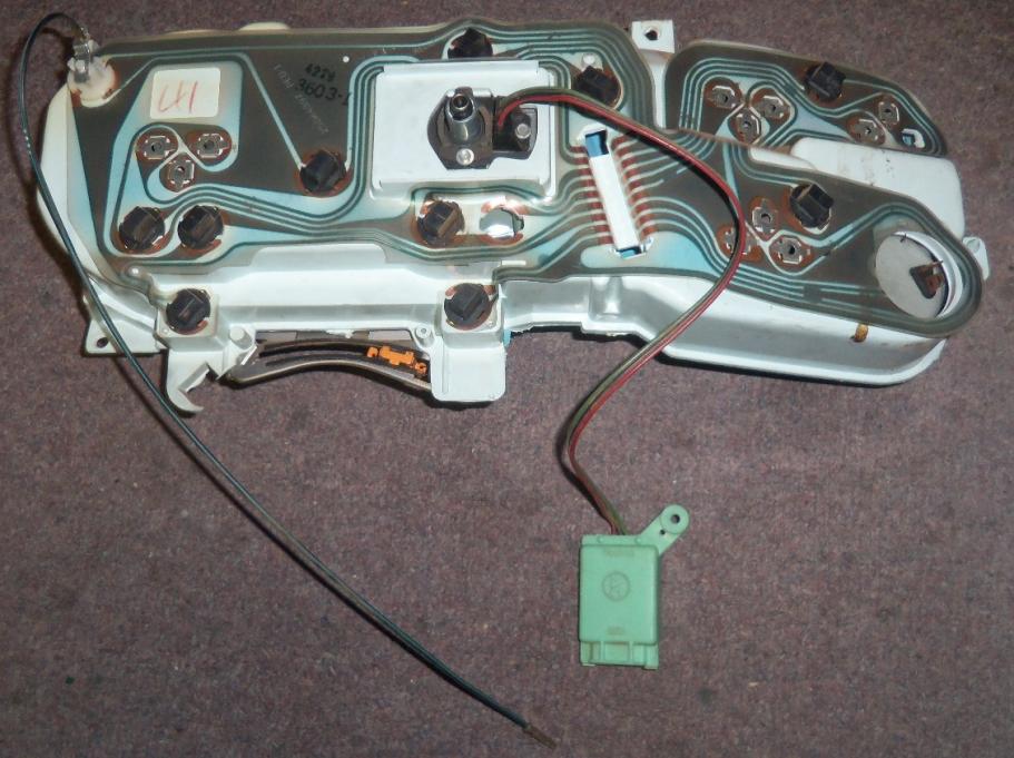

I haven't checked it out yet, but next ave, is to figure out what this black wire above the fuel gauge goes too. It wasn't hooked to anything. Kinda wonder if maybe it's not a cluster ground. :shrug:
My cluster and behind my dash is very very filthy. I'm hoping to clean all that up today, make sure all bulbs ae good, found 2 bad already. Now I know why the 4x4 light didn't work. Make sure I know where every wire goes and it's hooked up, and looking over the printed circuit looking for any breaks. Everything worked in this cluster except 4x4 light and Temp gauge that I recall. So unless those other gauges get a ground from another source, I'd say that black wire probably isn't going to fix my temp gauge, but I at least want it hooked up where it goes.

This one? If you look closely, it's not a wire at all. It's a fiberoptic cable that goes to the ashtray to give light when the dash lights are on. I'm thinking your temp gauge is bad or your sender is bad or not grounded right because the gauge uses the same ground as the dash lights and other gauges.
attachment.php
Awesome Again. I figured it had to do something like cuz it looked like a light not a plug.
