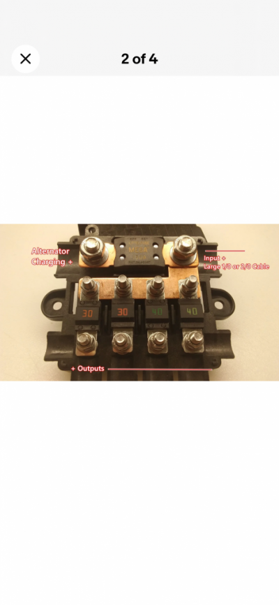

When I completely retired with my Painless kit, I got rid of this junction box. The Painless kit comes with a large fuse that gets installed on a block that they also provide

Is this what you are asking about? It's a 1982 OE terminal block but with aftermarket wiring, so yours will be wired differently. This one connects 8 gauge wire from the starter BAT terminal to the fuse panel. Small gauge wire goes to alternator sense terminal. The metal strap is just a jumper. I used Mega fuses on the other side of the firewall instead of fusible links.
