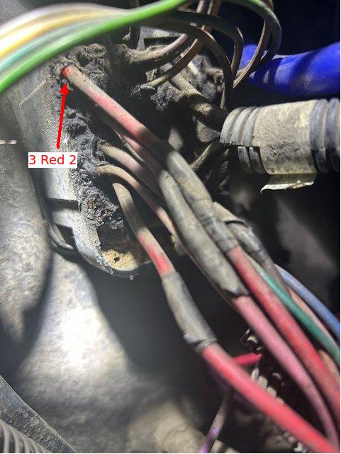

There should be two 10 ga wires routed from the junction on the firewall to the bulkhead connector, each should have a fusible link. This is their position on the bulkhead on my 1980…

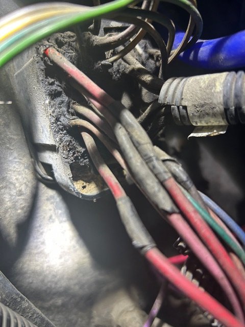

if overloaded the brass connectors burn up and melt the plastic around the connector. I don’t have an example of a burned up bulkhead but here is what a healthy one looks like. There’s different ways of repairing a burnt out connection, on way people do it is to cut out the connectors, splice the power supply wire, pass it through the bulkhead and splice it behind the fuse block.

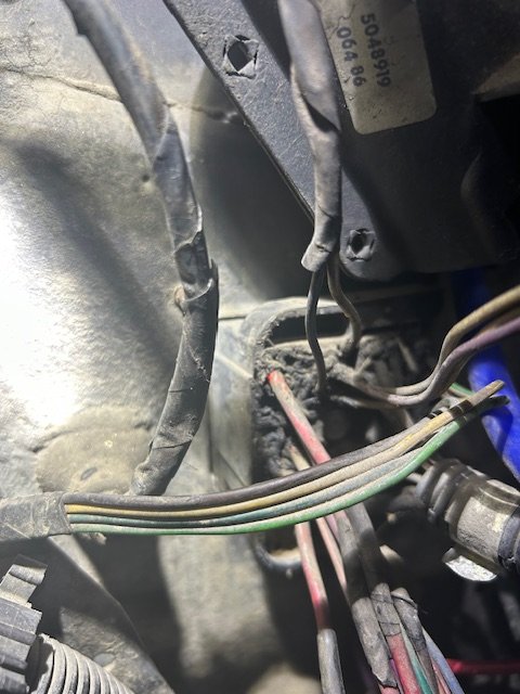

is this pic from the engine side or the cab side?
heres what mine look like in the engine compartment at the fire wall

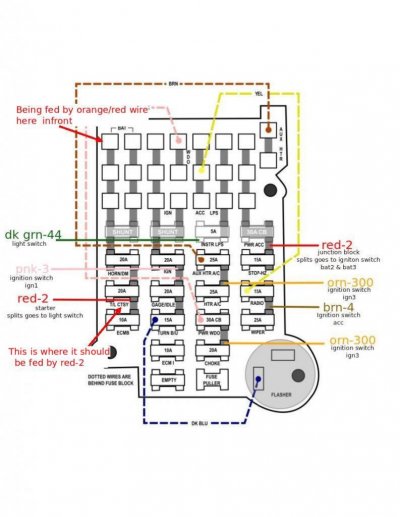

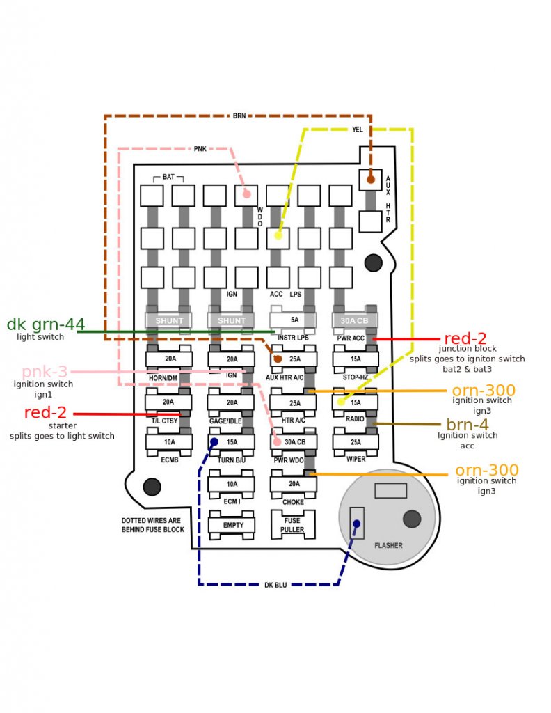

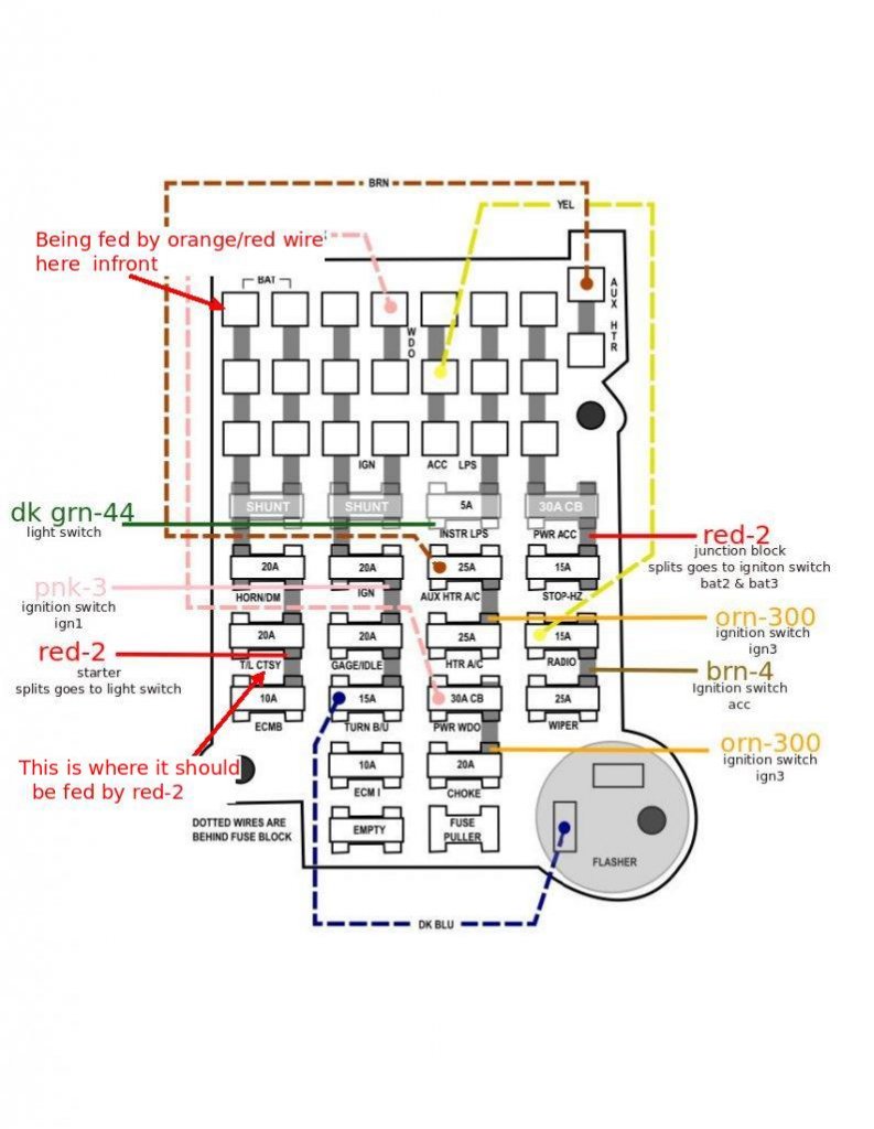

Attached is power coming into fuse box- It tells were it is coming from. Dark grey in the fuse box is the power going to fuses.
Here is a link to wiring diagrams- download and look at 86- shows how the wiring runs. I would suggest quickly reading the first few pages also-very useful info to know. I wonder if a previous owner spliced in a fuse instead of replacing a fusible link. (If so, I would replace it with a fusible link.-)

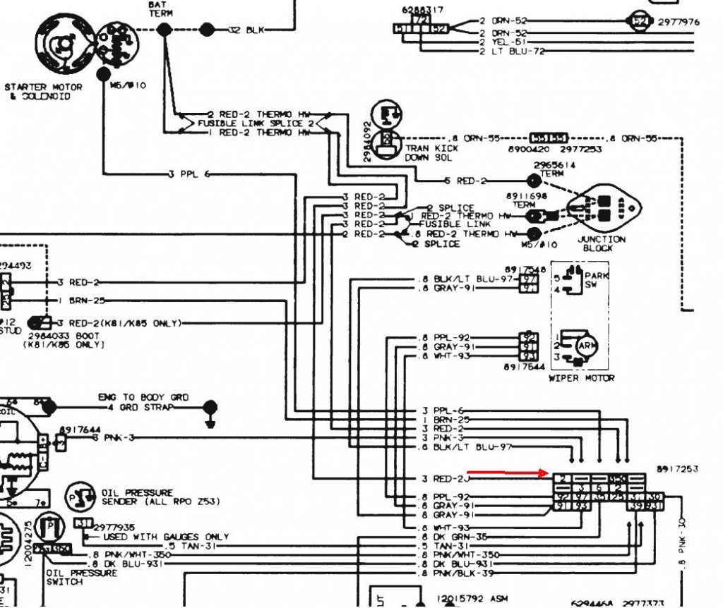

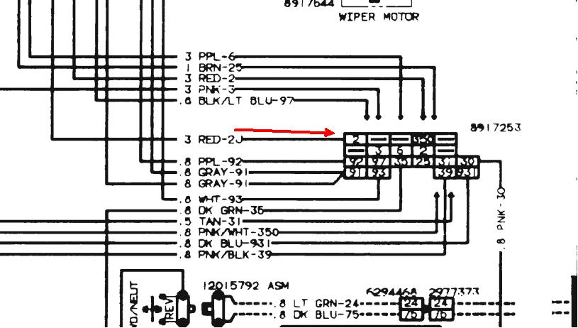

See attachments. Shows how the wires originally were. First number is size of wire (metric) Then color of wire, then circuit number.
My first picture is the same as yours just out of the truck and cleaned up. That big section of wires is actually 3 separate connectors that snap together before you bolt the plug into the bulkhead.
The 2 red 10 ga wires in your picture are the ones that supply the fuse box with power.
My second picture is what it looks like when you unbolt the connector and wiggle them loose.

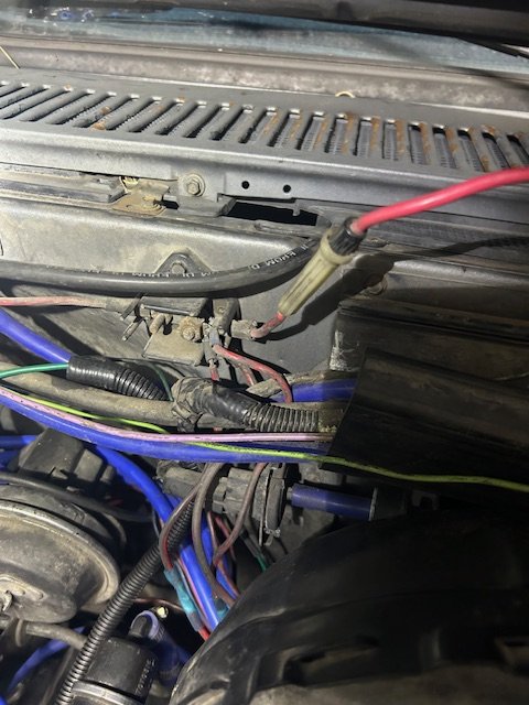

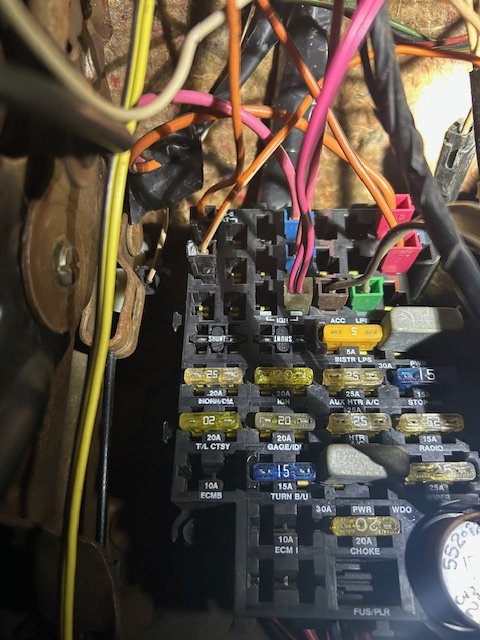

the fused on is coming off the firewall junction block, under the dash they have it tied into the orange wire which is plugged into the top left spot on the fuse block, according to wiring diagram that is to feed power to a clock which my k5 doesn't have, also looks like all the fusible links have been removed from the other wires on the junction block, it looks like all the original wires are there feeding threw the bulkhead connector

Previous owner screwed up your wiring. It appears they are back feeding that portion of your fuse box by that red (fused) orange wire. Not good really.
What happens to your tail lights when you unplug the wire (with parking lights on)?
Also is your horn/dm fuse good?
I'm not quite sure why your cab lights are working at all when the red/orange wire is unplugged
In attachment-you can see it is supposed to be fed by red-2 (bottom left) That is the same red wire I labeled on your bulkhead in previous post #5
I'm betting they ran one red wire from starter to junction block. Then two red wires from junction block to the bulkhead. The red fused wire-I know. Where does the other red wire on the junction block go? Alternator?

Jgonick, where did you get the beautiful fuse block picture? Honestly that made a lot of connections (pun intended) for me. I have been wrestling with wiring in my 85 k20. I have the wiring diagrams from the factory and then nice laminated version from a vendor. Is that picture from an online source you can share their link?​
Jgonick
Jan 12, 2017
448
574
West Texas
Joel

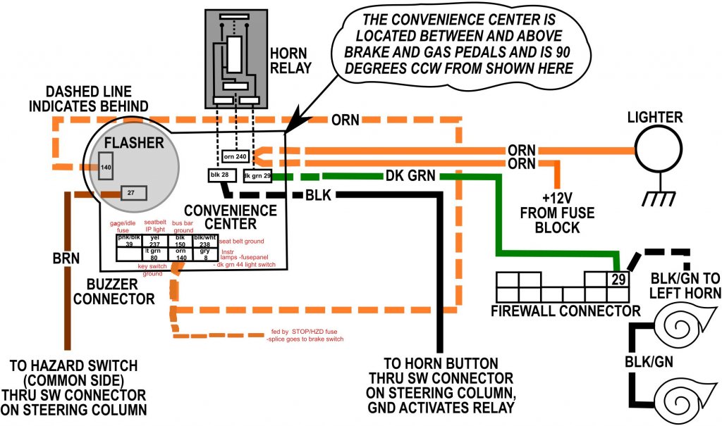

@ kgerrish I found it somewhere on a forum a while back. Someone did a great job on it. (Wish I knew who- I would definitely give them credit) I just added where the power came from.. I think the same person also drew the convenience center- once again I just added the circuit numbers.
