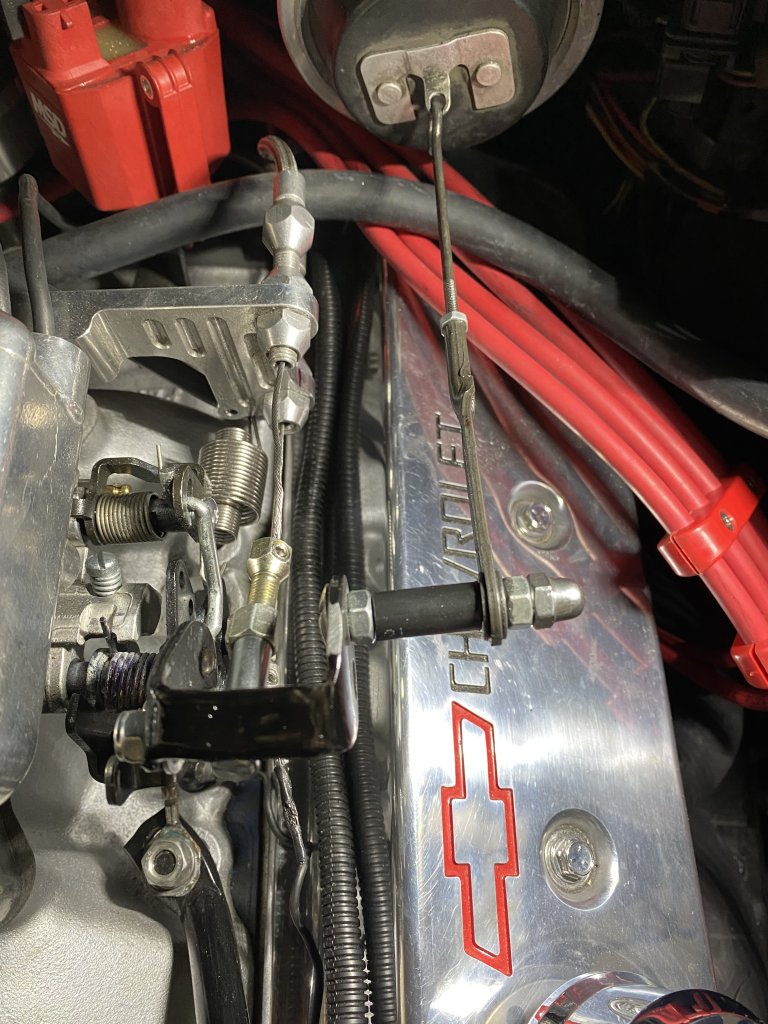

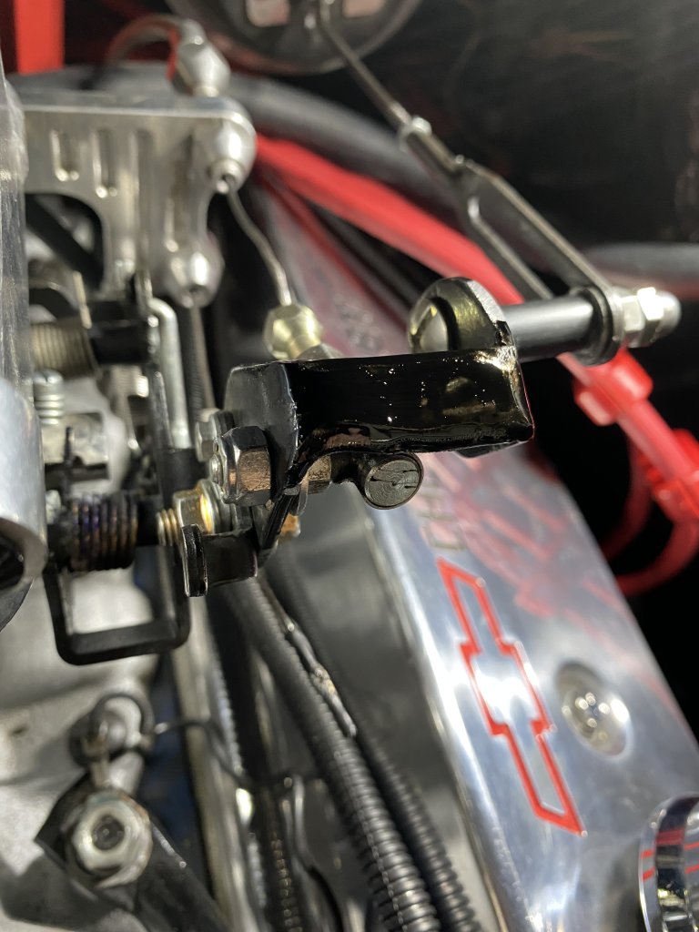

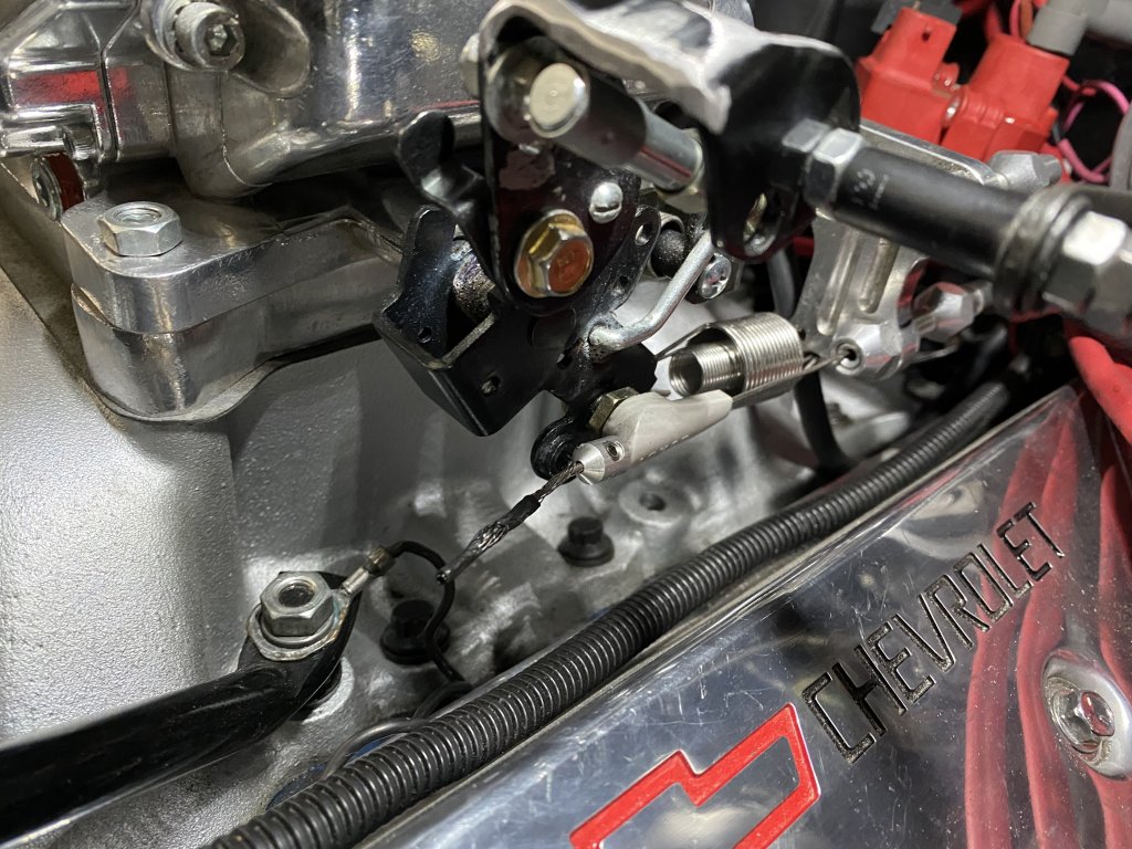

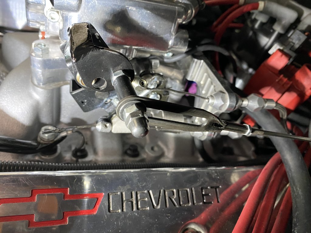

DB we just went with a stock replacement switch, I think I got it from Brothers or LMC, I only replaced it because my factory switch was a bit loose and that was before Sniper fitment. The oil pressure switch relationship to the fuel solenoid was the hidden issue we had and it took a bit to figure it out. I think from memory the fuel switch wires to the solenoid are purple . We ran new switched power to the high pressure pump, through a relay that the Sniper controls, or at least that’s how I remember it. I wonder if the factory style solenoid will handle the high pressure, might not be a problem for you. The factory pumps only run at around 6 or so PSI. As for the cruise control, that’s a whole different ball game, I have the mechanical side of it sorted but as we removed the ECM and most of the factory harness in the engine bay, the electrical side of the cruise is still a mystery. I think it’s only a simple fix but have spent many hours studying the wiring diagrams and still have not got it sorted. Happy to take photo of the linkage /bracket I made for the cruise control arm to go on the Sniper.

I'd love to see what you did for linkage bracket.

in the mean time I took a few photos of my linkage set up , hopefully they may be of some use to you.
