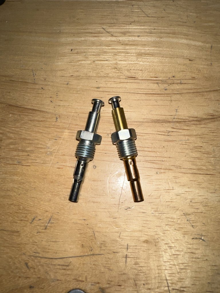

I have a 77 C20 long bed. My passenger side courtesy lamp switch in the door frame isn’t working. I tried to clean it and refurbish it with contact cleaner but the contacts are shot. I’ve ordered two sets of switches from two different vendors and they are both oversized. The sleeve that the contract slides into is longer than the original so once installed, the door makes contact with the solid sleeve and won’t allow the door to close. Who makes new switches that are identical in dimension to the oem so I can resolve this issue. Maybe a trick or modification to the switch? Anybody else encounter this nonsense?

I think I'd cut the offending tube to match the O.E. switch with a dremel or hacksaw,then cut an equal amount from the stem of the switch,to use,while I looked for a new switch

Well I’ll be damned. Thanks @Matt69olds! I’ll give that a shot. I was worried about denting the door or the frame or both. Glad I asked. This is my first post on one of these threads. Seems like a great tool. Glad I did.

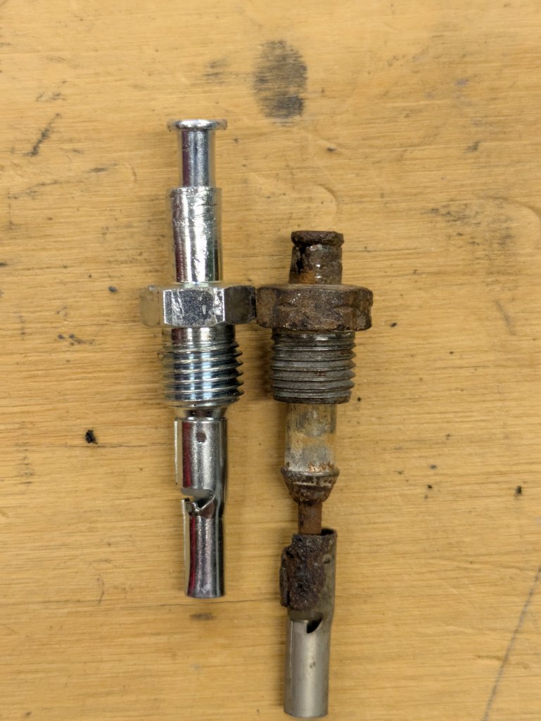

Did this work? I bought a new switch for my 81 from LMC but it is solid, there is no pushing the post into the nut. I even put it in my vice to try and push the post in and it just destroyed it.
Picture of before I tried pushing it in compared to my old one. Plus you'll notice the new one is not fully threaded so you can't even tighten it when installed.

Yes it did. It worked like a charm. BUT… I had purchased two different sets of switches from two different vendors. One set I got from LMC is like yours. Threads don’t run all the way to the back of the nut. That’s a dealbreaker. As soon as you thread it in to where it should tighten it just starts spinning because you run off the threads. Not the most stunningly, brilliant design. I got a different set from Tuckers. They were threaded all the way up. They both were too long and just needed pushed in. I couldn’t push them in by myself. Once they were installed in the door, i closed it and they pushed in as far as they needed to. I was super nervous it would damage the switch and/or the door, but I chose to the wisdom of the brilliant minds found in this forum. Gladly, it paid off.
