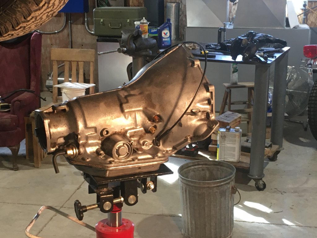

I had my 4l60e in my 98 z28, rebuilt at a local shop where I know the guy, but didn't last. Built my 350 at home using two books, and some videos. Yes I did have some troubles, had to take it back apart a few times, but though nervous whin I installed it, it worked amazingly well. It was behind a 454 with cam, airgap, holly 750, 1 7/8 headers. I also installed a transgo kit...Have not been able to break it. Went to get a ton corn for the cows, and some Hispanic bros were all over it, So I pulled out front and did a great burnout. Buy a ATSG book and a HP 350 rebuild book, and read it. This was before I knew Nick, (we are fortunate to have him here,) Everything needed to rebuild the trans I made in the shop.
