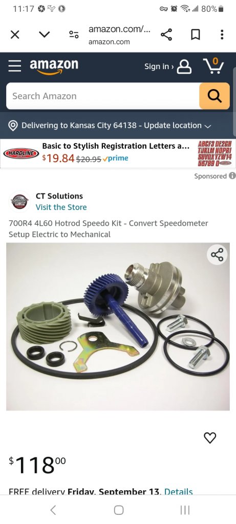

What not swap the speedometer drive and tailshaft housing from am earlier 700r4 and keep your cable speedo? If for some reason you can't find cable speedo 700r4 to rob parts from,you can use the speedo drive from a BOP th350 and a 700r4 drive gear and clip with your tail housing. Looks like someone sells the whole mess on Amazon and I put up a link to calculate gears.https://transmissioncenter.net/shop/speedometer-gear-calculator/
