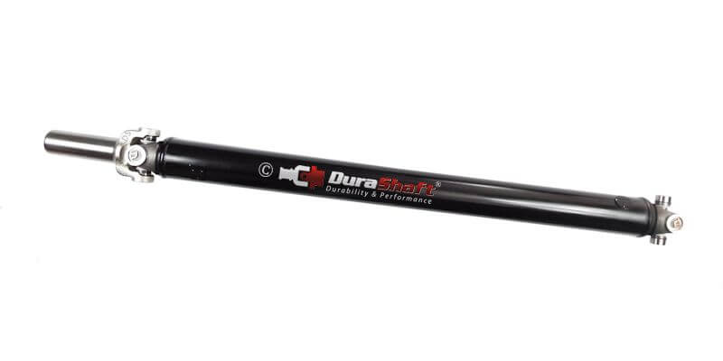

Accidently found a place to get a driveshaft for you.
Thank you! I’m going to order it. Just for anyone wondering the 92 Chevy drive shaft was the correct length u-joint to u-joint but the length of the splined yoke is about 1 3/4 longer for the 700r4 and the yoke on the differential side is a little to wide. It could work if you find the right u-joints and swap the splined yokes
