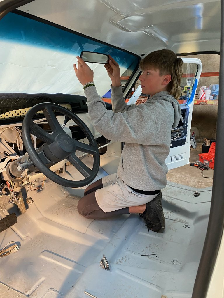

Works and drives fine. Only way he stays motivated to finish his project! And yes on oil pressure gauge and cluster connections from above! He learned both the hard way!
