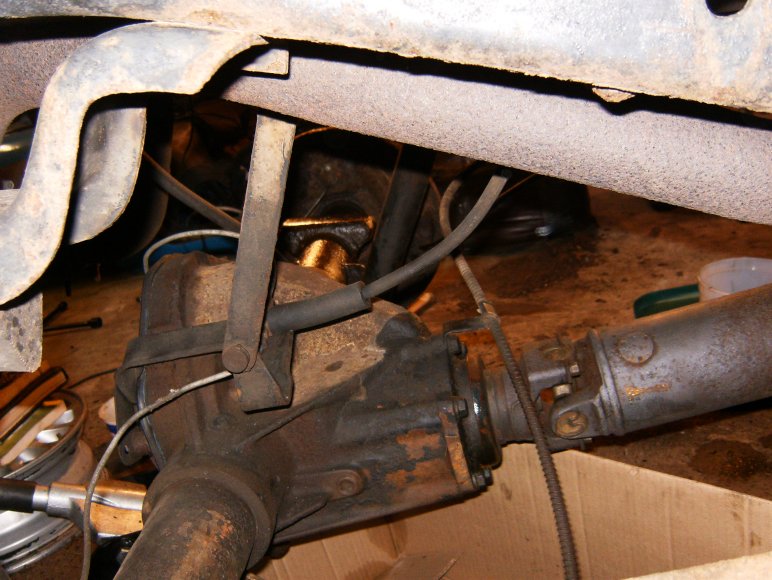

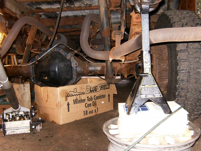

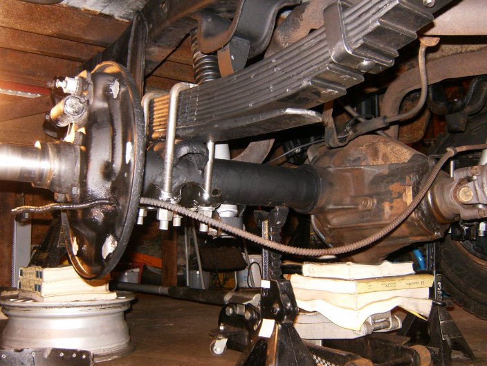

I don't know if you can see it on these imges, but (on my K30 -single), the valve is gone and has been replaced with a standard tee. The bracket remains in place for mounting purposes. Braking capability is as factory.
