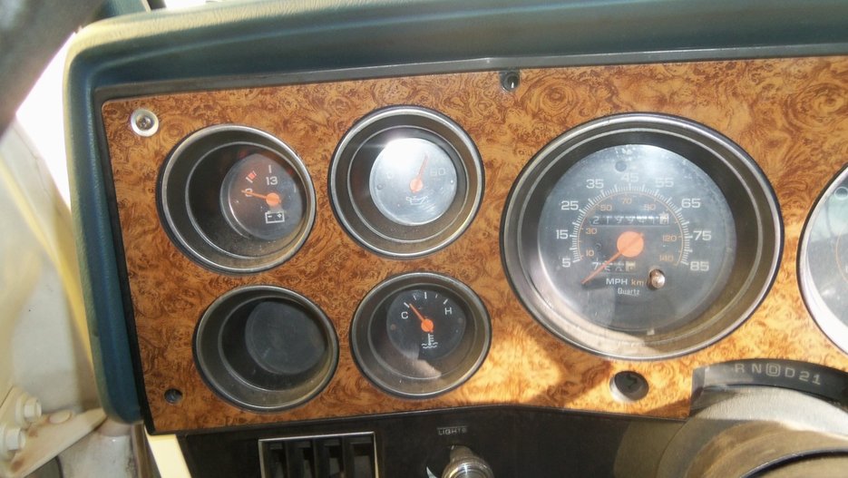

47,210
9,482
there is one on there now for $120 usd. has 219,000 miles on the odo and is in mph. large fuel guage, clock delete... do you know if the faceplate on the speedo can be swapped for KM/H? both are registered for 140km/h or 85mph so needle would techincally be in the correct position at any speed, looks like the faceplate is held on with 2 screws or rivets from what i can see? does the needle just pop off?
Sounds identical to the one I have but that's not mine listed on ebay.
