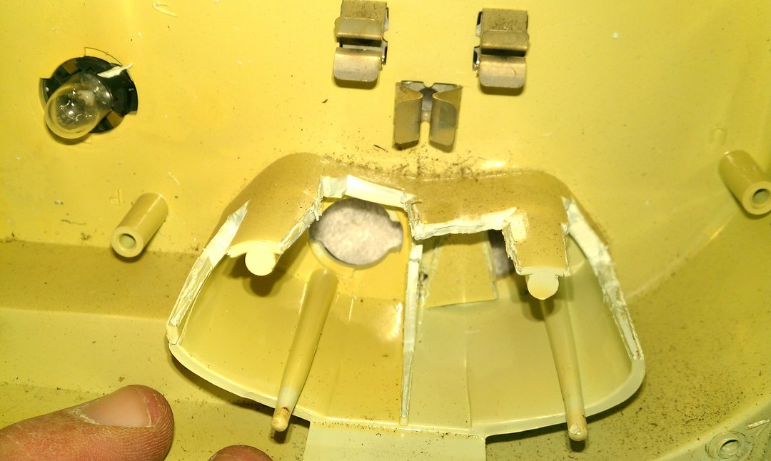

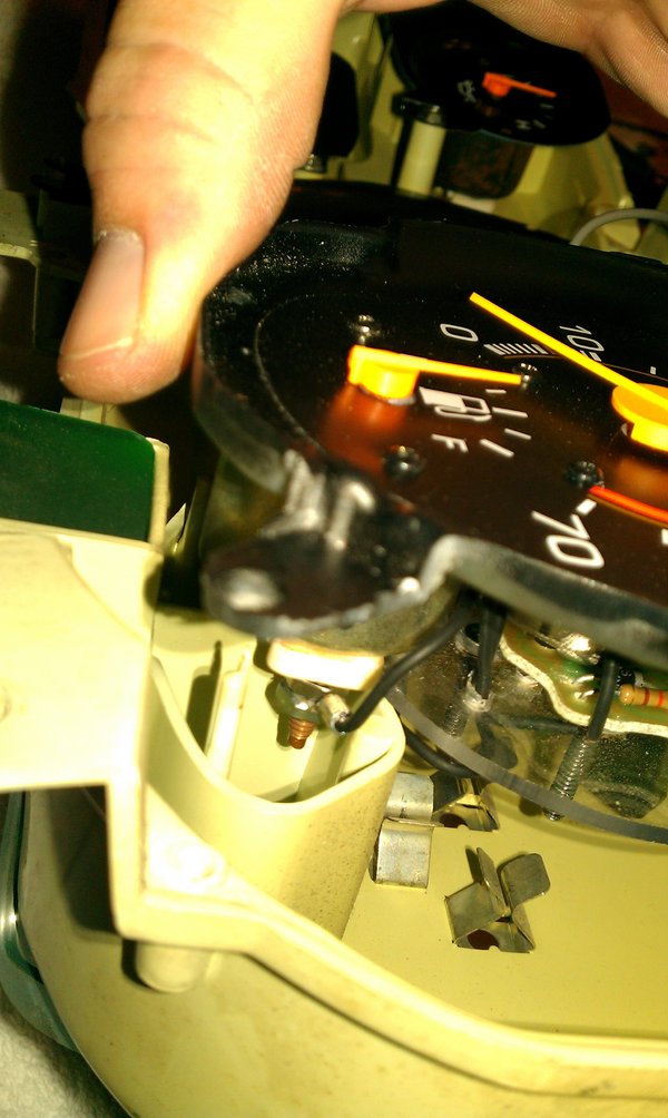

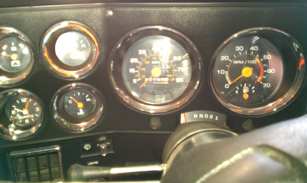

J Knight
Sep 8, 2011
4,298
145
Baytown TX
82 Chevy
350ci
I put one in my truck a few years ago, loved it.
Note that you can order the older font to match the 73-78 gauge clusters.

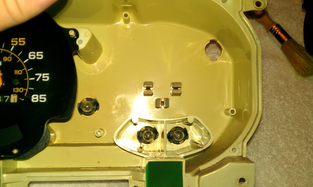

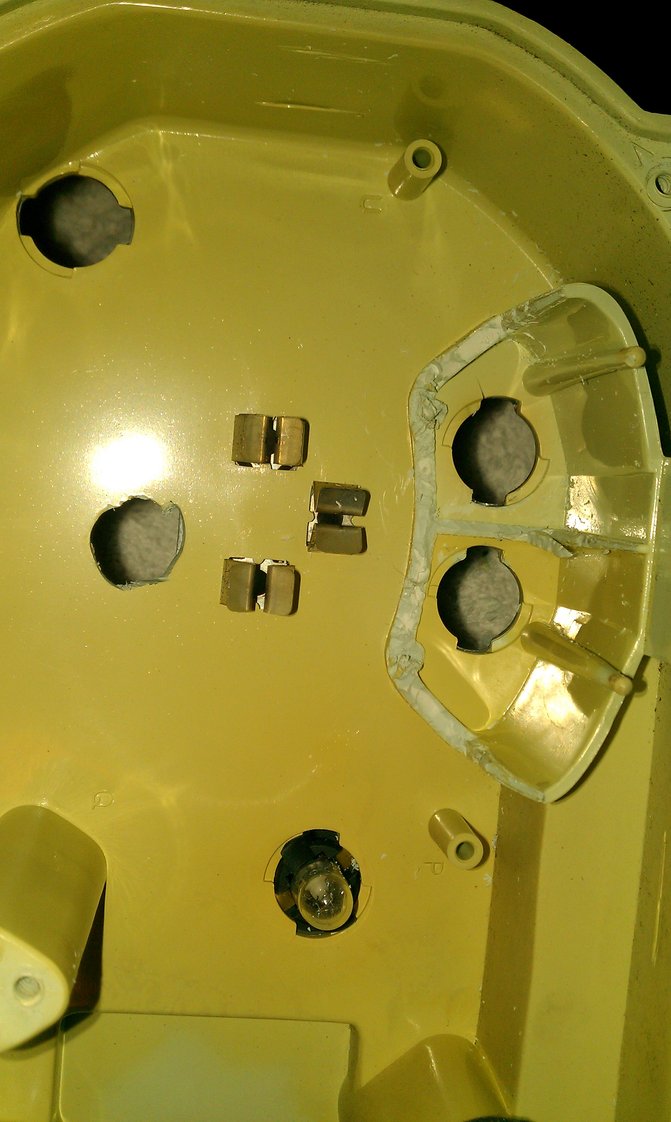

Thanks for letting me know about the font. I painted my needles with silver reflective needle paint when I replaced my circuit, bulbs and lens and have some left over for this. How much of the cluster housing did you have to cut out? Is your distributor OEM and if so was it plug and play or did you have to splice into a wire?
J Knight
Sep 8, 2011
4,298
145
Baytown TX
82 Chevy
350ci
You just have to cut a small part of the cluster and it is plug and play with any ignition.

1987 GMC Jimmy
Automobile Hoarder
Jan 23, 2016
5,848
2,390
Mississippi
Jesse
V1500 Jimmy
Mmm, that looks sharp. I'm weirdly sentimental about my "4 Wheel Drive" light, or this would be on my list.
