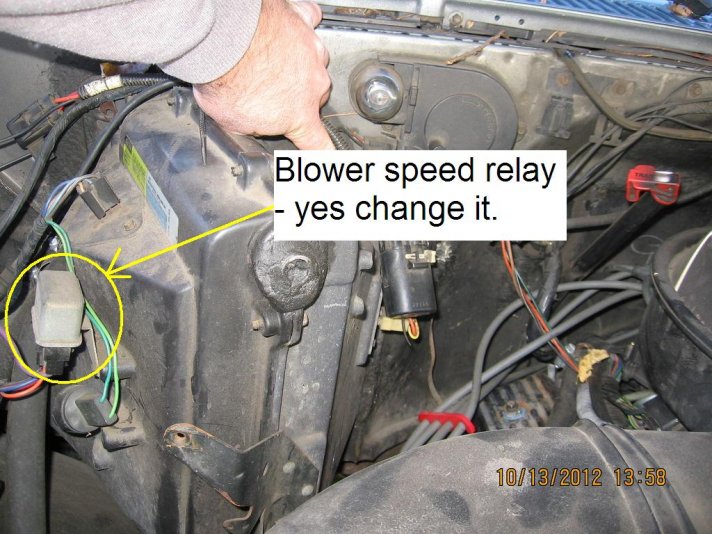

Fan relay is all that is left to replace:

Thanks for confirming it. I didn't want to throw more parts at it if it is a wiring issue.

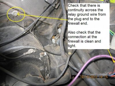

First, before buying a new relay, check that the relay coil has a good ground connection. Check the black wire for continuity - also that the ring terminal is clean and tight to the firewall:

I agree with chengny, has the exact same problem on my 87, replaced relay for about $15 and now works great.
