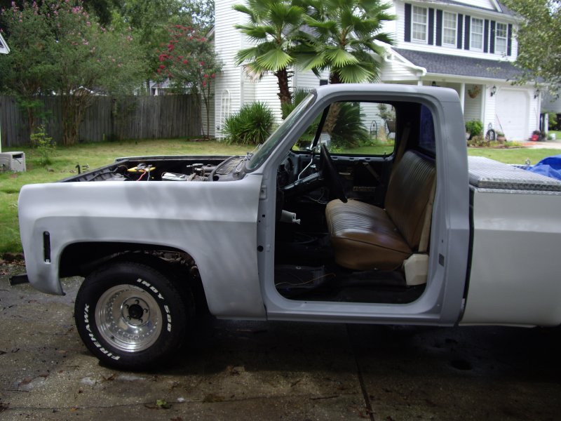

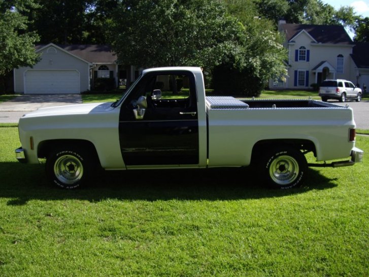

80's doors will work fine. Here is an old picture of my 74 with 83 power window doors on it. When you get the doors also get the power window harness that runs under the dash of the door donor. Biggest bitch is drilling the hole thru the cab door frame for the power windows, locks wiring.
Thanks for the good to know info, every bit helps. BTW are those centerline wheels?
