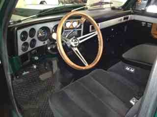

I'm looking for some parts to try and convert my GMC back from Chevy. Only problem I'm not sure what if any difference there is!? Also looking for replacement door panels. Thanx!

The only difference that I'm aware of between Chevy and GMC is the badging. Are you trying to return it to stock and remove some of the aftermarket stuff?

No, just wanted to make it back to a gmc again. So all I have to do is swap out the dash badge. Any clue how to remove that trim piece?

Remove your gauge bezel then dash pad, it is all accessible from the back side of the dash pad.

If the badge is on the right side of the dash there there are stamped nuts on the back side, you can access by pulling the glove box off.
Can you get me a pic of the AC vent there to the right of the steering wheel? I would like to look that mod over you got there, are they gauges?

Sure, here you go. the badge is on the right btw.

Notice the two small holes in the dash above the glove box. Thats where you can get to the badge if you dont want to take the dash pad off.

Here's a better shot. The only thing I don't like, is it leaves two blanks in the gauge cluster, and the panel it's self doesn't attach in the upper right corner. I'm going to pull the instrument panel off to see why.
