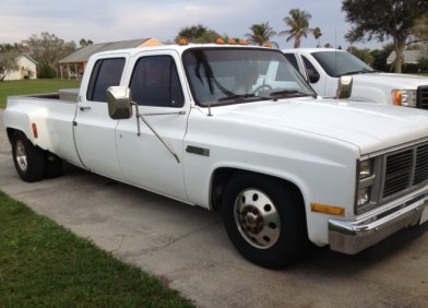

Hello guys! this is my 1st official post. and of course its a question.
I have a 88 crew dually
attachment.php
I like the body line of the 77ish fenders to make a nice two-tone
attachment.php
will the 77 fenders bolt on to an 88?

To do the swap, you need to change all the front sheetmetal. Fenders, inner fenders, hood, hinges, core support, etc. In addition to that, you also need to change the wiper stubs and the core support brackets on the front frame rails. The bumper will bolt to your existing front bumper brackets, but the outers need modified (a large section removed basically).
