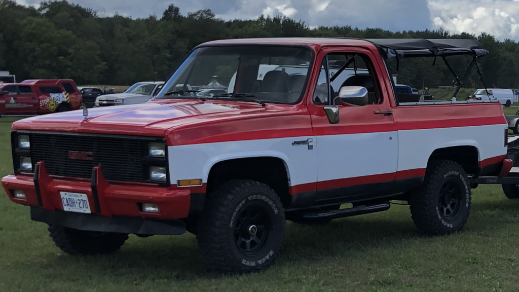

Thanks everyone.. I think I'm inclined to just do it. Winter is the ideal time anyway since the truck doesn't see the road again till spring. I was just wondering if the general tone would be "don't mess with it" or "go for it". Seems like no one has any particular concerns and the risk of messing something up seems low so why not I suppose.. Apologies for bad form in not posting a pic so here's one..
