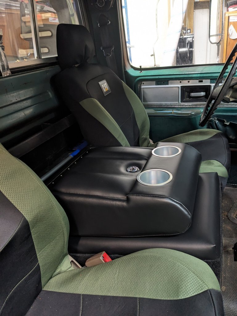

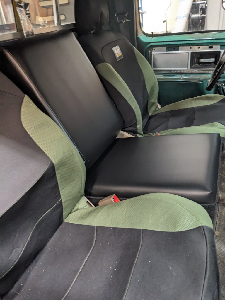

Found a super cheap set of 4Runner seats (my personal favorite) and went to work.

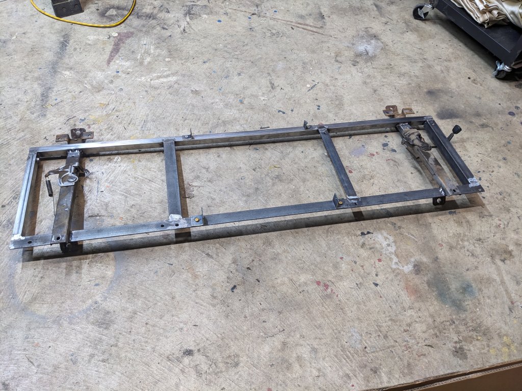

I built a platform to span the original bench seat brackets, cut the mounting brackets off the 4Runner sliders and mounted them up.

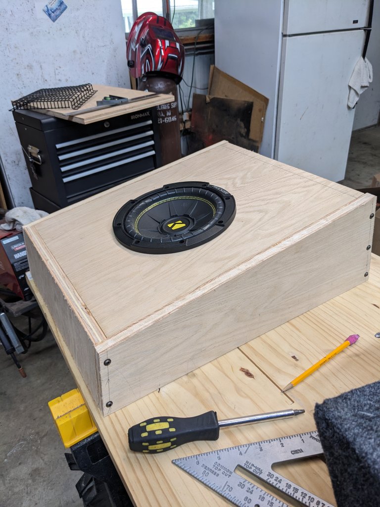

For the center seat, I had most of a sheet of 3/4 furniture grade plywood, so I built a down-firing subwoofer box into it. 2" of HD foam on top, all covered with heavy duty Naugahyde and carpet I had left over from another project.

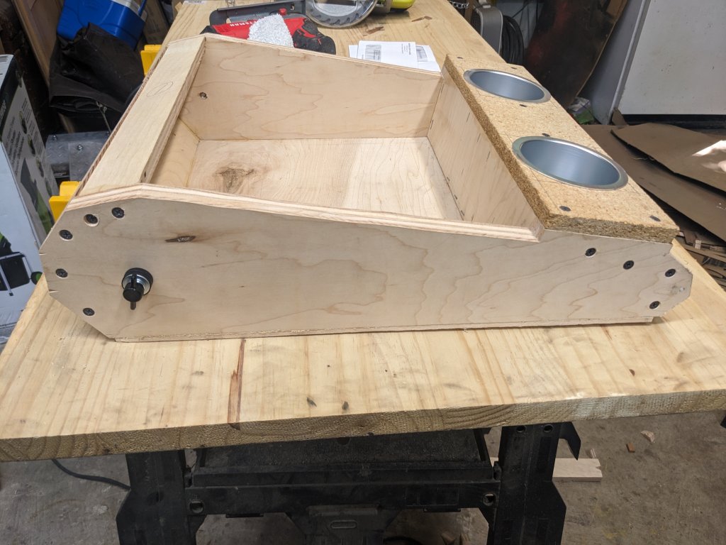

The armrest/storage console was a bit of a challenge, but I'm pretty happy with how it turned out.
