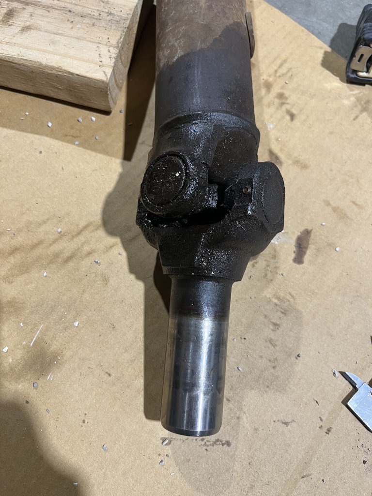

ok what is the fix for the leaking center hole in 2wd th350 output yoke.. i need to at least stop a couple of the many leaks from the old original th350 in the 75 until i can manage to find a 465 trans and clutch link parts etc to do the swap.... finally,,, some day.... im gonna fix the leaking speedo cable gear bullet o ring seal now and then hope i can do something about the yoke center hole leak next... the front seal i cant do anything about because im not pulling the trans until i put a 4 speed in

Typically it's the output shaft seal. Lots of videos on YT.

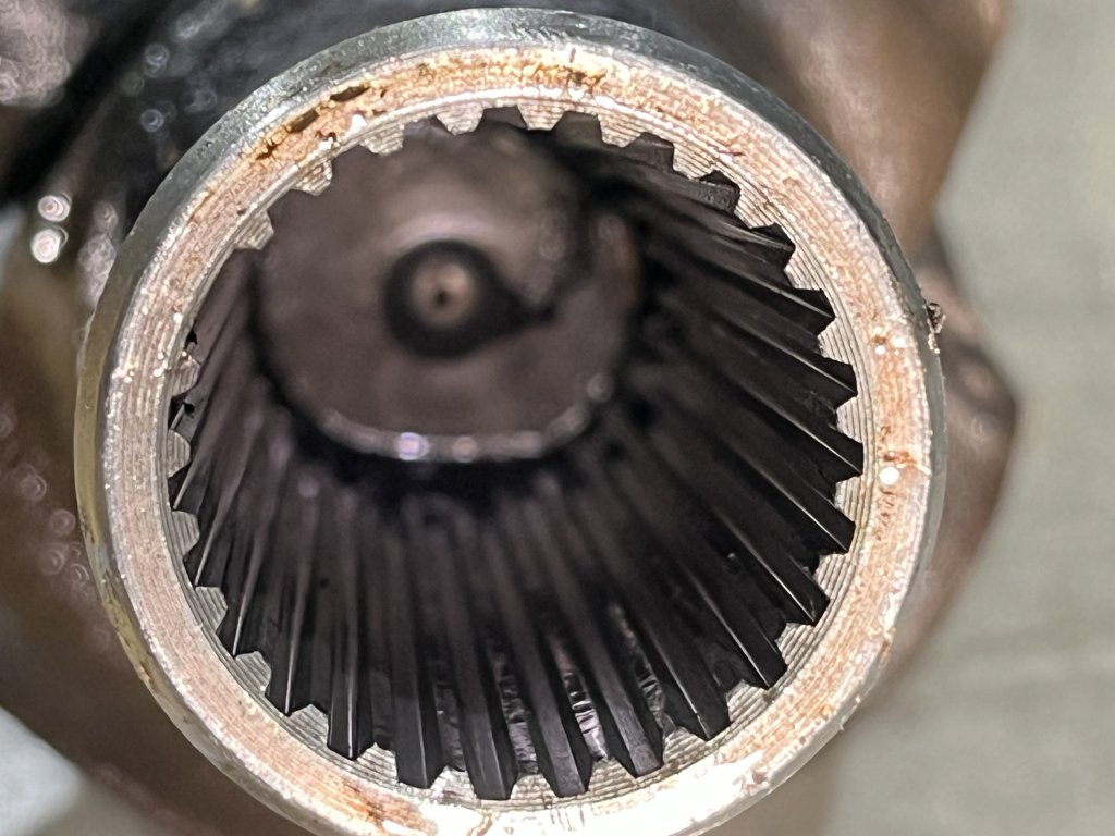

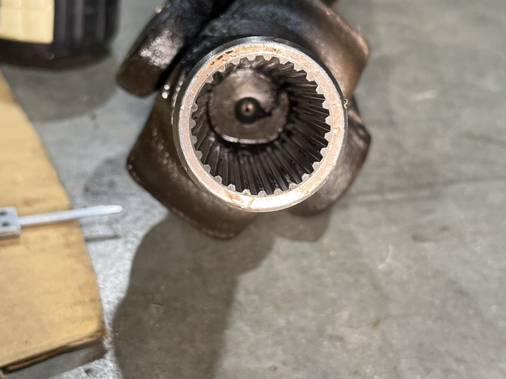

There is a o-ring that seals the yoke to the output shaft inside the extension housing. It’s inside a metal sleeve on the output shaft. It’s purpose is to prevent fluid from leaking around the output shaft/yoke splines.

hmm ok where is it at pics? do you have to unbolt the tailshaft ext housing from the trans case to replace this o-ring.

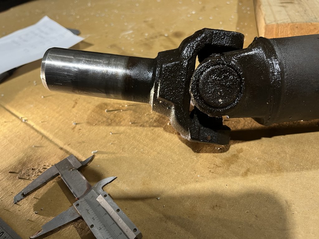

ok so did some research and its only the 9" tail with two piece driveline trucks that had this sleeve and O ring..
the cars and 6" tail trannies(69-72 trucks) didnt have this.
i wonder about the super long 12" tail TH350 in the big 70s station wagons though...
well i just pulled my shaft housing off the tranny under the truck and finally just got the stupid O ring out of this sleeve so i can replace it now hmm..
it was all hardened and cracked up split...
700r4 used the same ring and seal as TH350.
ACDELCO part # 8654063
o ring seal sleeve
o ring
GM AC Delco 3764601
