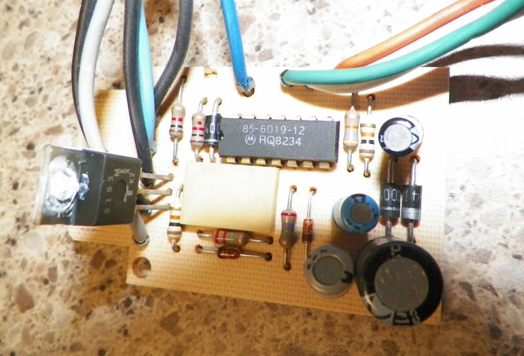

Posting a pic of the delay circuit board on my truck, 1983 Suburban Silverado C20. The wires go to the jack and plug that splices this into the wiring harness.
To the left side of the pictured board is where the delay switch plugs into tabs on the board.
I've encountered at least three different physical versions of this board GM used that plug into the vehicle differently, and each of them seem to have at least two part number substitutions along the way before they became obsolete.
This seems to be the most basic physical version of the board, with only one IC chip and one semiconductor/thyristor/SCR. Other versions of the board have different IC chips, one or two transistors as well as the SCR, and a different physical connection to the wiper/delay switch.
My point is the EXACT solution will vary depending on what version delay board you have and what your symptom is. With further input from others who have different boards and different symptoms it might be possible to create a generic kit that fixes an overwhelming percentage of those problems, but unless we figure out an effective substitution for the IC chip it will be the biggest stumbling block to creating a 100% effective kit.
I have managed to pull the SCR on this board and it tests good, that's the black component with three legs in the bottom left of the picture. I suspected it first just because it has such a cheesy heat sink to cool it, and my symptom of an always on wiper no matter what position the wiper switch was in would suggest a permanently switched on SCR.
The diodes, resistors and capacitors on the board help create the "delay" we get, depending on how many are switched into the circuit with the SCR.
I have seen digital logic drawings for two different IC chips used on this board and it seems to be responsible for switching in how many delay components from the board are used, according to what the delay switch position is. I'm ruling out the IC chip for now just because it's a very low voltage logic component and I can't even find a suggested replacement for it.
I've ruled out the resistors as a last resort since there are no overheating indications for any resistor on the board.
Since the SCR tests good, two different switches didn't change anything, and the symptoms don't change regardless of the switch position; I don't think it's the IC chip and this leaves either the diodes or the capacitors. They are common failures in any circuit and at the very least they're easiest to find and replace. Moving forward....

Workin' on it.
Those electrolytics are ~40 years old.
