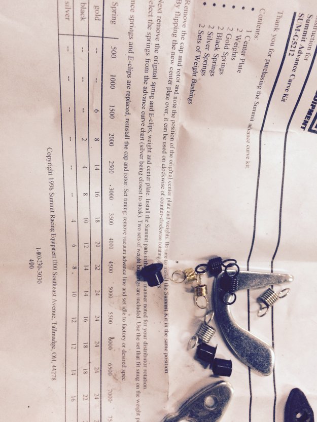

All looks like good advice above. Also agree, don't use the weights. Unless you're going to be a full race engine and want all your advance while stalling out on the tree, and no vac advance, don't use those weights.
All depends on what the motor can handle with the compression and fuel being used and the load put on it, every vehicle/application is different and you don't know until you try it, 12* initial and 36-38* all in by 2800-3000 is average starting point for mechanical, average 15* on the vacuum at cruise then go from there, if it works you can try squeezing a little more like having the total come in at 2500, if that works step up the initial a couple degrees and see what happens and so on, "ONLY" the motor will tell you what it needs period. On my beater the best I could get is 14* initial, 37* total in by 2700, 15* vacuum for 52* at cruise, only thing I have to run a colder plug in the summer when the temps get up around 110*, OH, and that's with 87 ethanol skunk piss, now my nova that's a whole different story...That's new to me. I've always thought 36 degrees full and total advance is all you'd want on the street.
