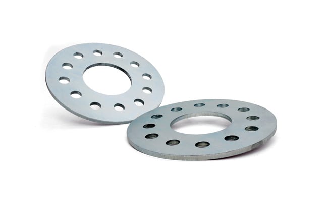

I don't want to start a new thread with the same thing, but how do you guys feel about the slip on 1/4" thick spacers?
I have some wheels ( 3 sets of identical wheels in 15 x 8 + 0 ) and I'm really close to the tie rod end link on the front. The wheel is so close that if I have stick on weights on the wheels, then it hits.
These are what I'm talking about
4,227
6,196
Only 10 lug nuts for 16 studs ? Any wheel spacer thicker than 1/2 is not safe with factory studs regardless of counter bore. The thread depth is greatly reduced.
Not only is the thread count reduced the aluminum has to be thinner and therefore more likely to pull through. I ve run lots of spacers,no issues but I researched failures to see what I didn't want. And I still occasionally check torque on them. I just realized I researched failures not success so I wasn't under the illusion they were nbd. I knew what to avoid.
