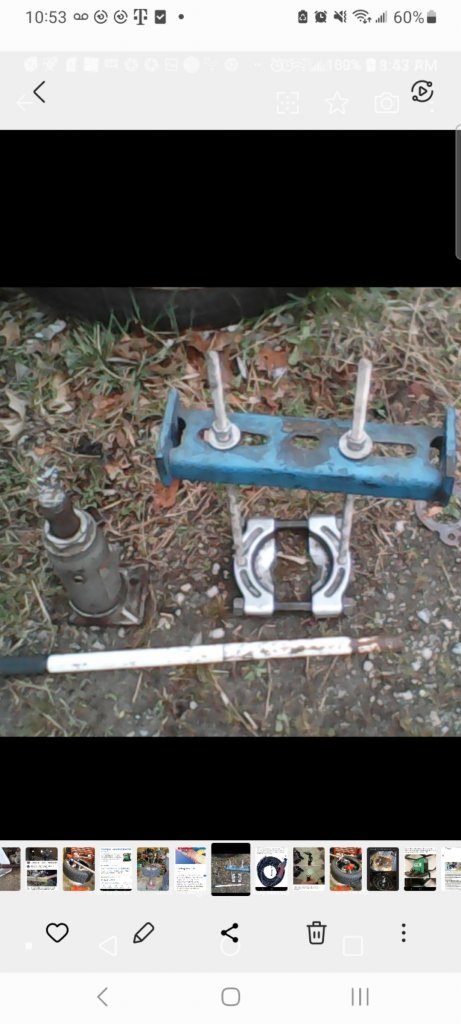

I have a press I use this way more. It's too convenient.
