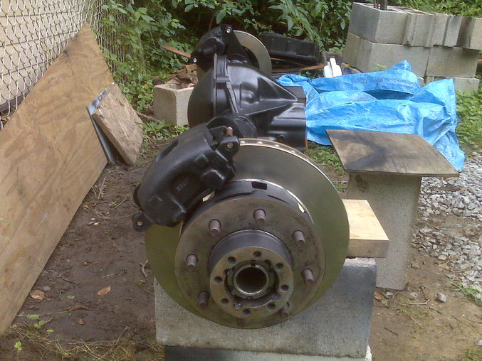

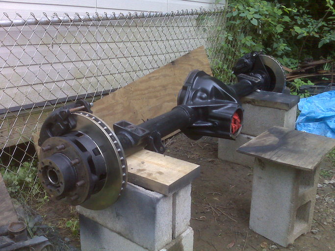

I used Offroad Design's brackets...
http://offroaddesign.com/catalog/14FFdisckit.htm
And 1/2 ton front calipers, pads and rubber lines. I welded large washers to my top leaf spring plates to mount the rubber lines to. I re-used the wheel studs I removed from the hubs, I know that's supposed to be a no-no but with regular open lug nuts there was plenty of threads to hold. I did not use the larger master cylinder, although I feel if there was any leak it could be a problem. And I don't have a park brake at all now. :/ I did install an adjustable proportion valve from Jegs near the master cylinder to restrict pressure to the rear brakes but I adjusted it to the middle setting (same as if there was no prop valve) and I felt it was set good. Just a little nose-dive on brake, and you can feel the stronger rear braking but with no sliding. It will slide in the dirt a little though but I like it. The stock prop valve is still in place so that may be why I didn't need to fool around much with adjustments. Hope this helps!
Edit: also I did not use any brake backing plates/dust plates, and the rotors were from a k20.
