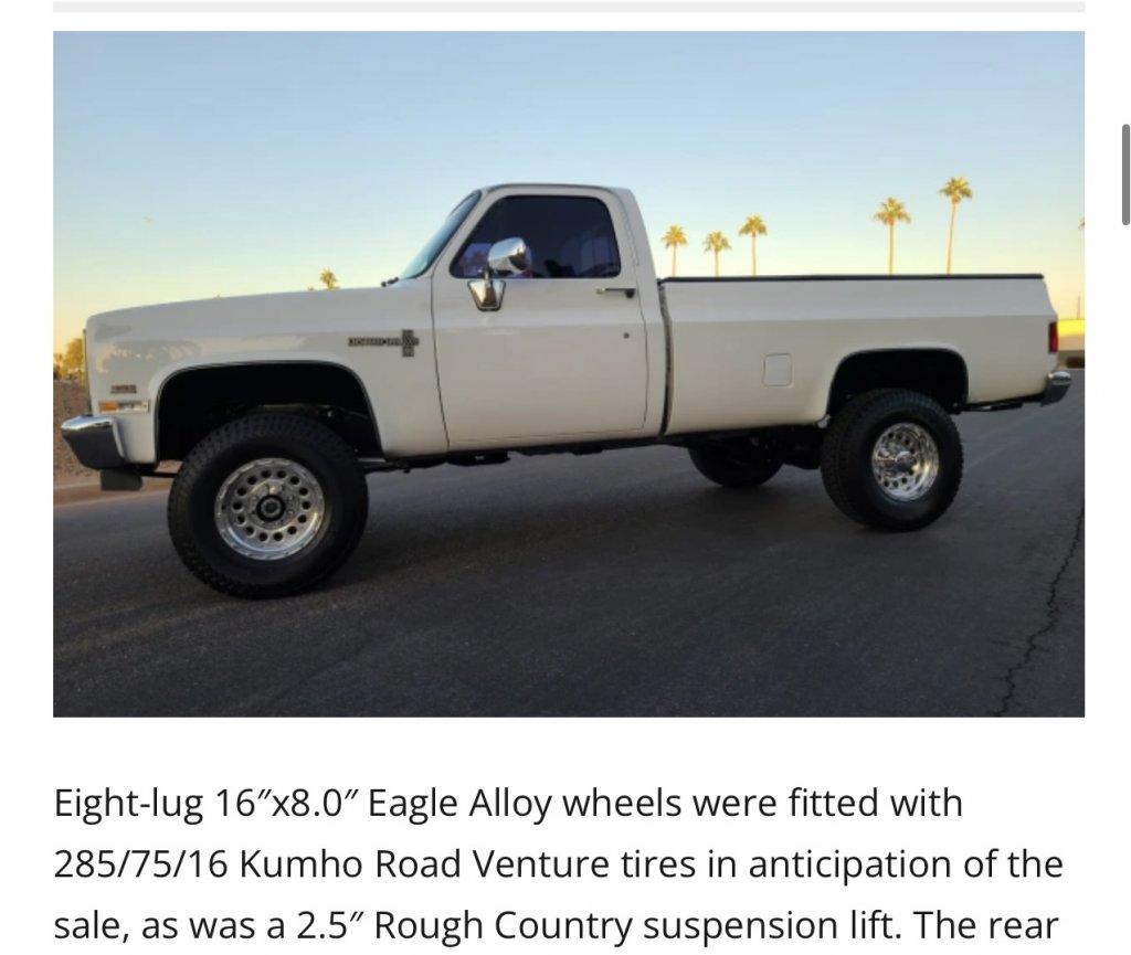

Hello everybody, I've got a 1979 Chevy k20 and got it lifted to 2.5 inches (skyjacker leaf springs and shocks) and wanted to get the biggest tire (preferably the widest) fitted without rubbing or trimming the fenders. The wheels I would love to install are 16x12's, but have no idea what BS I should look for without having knowledge about the tire size first. I would really appreciate your guys input and alternative wheel size recommendation's that I should look for to get that aggressive look. thank you all in advance. Here are some picture's of the rig:-

I had a two inch lift on 33s (15x8 rally) but I know a guy that runs 35s (15x7 rally) on a same truck, no lift.

I know that by reading a lot of threads by now that 2.5 inch lift will accommodate 32’s and 33’s. Wanted to know if I can go wider than 16x10 wheels, and if not how wide can I go on the tires if the wheels are going to be 16x10’s, thanks anyways rusty nail.

I have 35's on 17 x 9 rims, 4" suspension and 2" body lifts. Took the truck for a test drive yesterday and noticed a slight rub when turning hard to the right and driving into a deep ditch in 4wd. You may have problems with 35's depending on how you use the truck

That out of the way, 33s is the largest practical size with a 2.5 lift imo.
I have a 4” lift on a K20 with 35s (sort of, 315-75-16s) and they don’t rub but have in the past and will rub under the right conditions.
Rim width is somewhat immaterial, as the tires are still the limiting factor.
Unless you’re going for the brodozer look which you aren’t with 16s, then 12.5 wide tires are sort of the widest practical tire.
Most “standard” rims for these trucks have about a 50% backspacing. IE 8” rims are 4” BS.
I think less than 50% back spacing makes them more prone to rubbing on the backside of the fender wells.
The axle placement exaggerates this. And there are offset spring perch plates to move the axle forward an inch or so. I haven’t done this but may need to once I have proper 35s on the truck.
Same considerations apply to yours.

Thanks grit dog, so you think I should get 16x8’s and look for 33x12.5 tires? And also what is a safe BS number I should be looking for in that wheel I will be buying? Would really appreciate it .Thanks in advance.

Yes even 32" will meet metal if you twist it enough (and that doesn't mean a lot of twist).
16x8s will work for 12.5 wide tires. Your current wheels look like they could be 8" wide. I prefer wider. 8" wheels 12.5" tires is a great off road setup, keeps the tires on the bead better at low pressure, but 10" wide wheels for 12.5 wide tires is about ideal IMO.

10” wide wheels for 12.5 tire how tall can I go on the tire my friend ? I found a guy on the web who’s got 8” wide wheels except he’s running 11.2” wide tires can I do this with10” wide wheels? And if so will it be wider than his (when installing the 10” wide wheels with the 11.2” tires)? Thank you guys

Like I said above, I wouldn’t go more than a nominal 33” tire.
285 75 16, 295 75 16 or 33x12.50 are the popular or most available reasonable sizes in that range. All will be fine on a 10” wide rim.

Thanks buddy helped me a lot much love from the Middle East.
