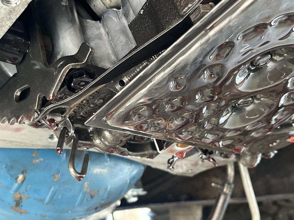

I just swapped out my engine and when I finally got it all running I dropped it into reverse and the d*** thing crawled forward. Lol. Was happy to find this post in here, mighty helpful. I personally know next to nothing about transmissions but good time as any to learn I guess.
I am going to start googling all the parts you listed above to become familiar with the job before I pull the pan and spend the afternoon on the creeper tomorrow but if you happen to see this and have any additional advice I would appreciate anything.
Thanks for all the info. Was about to open my phone and start looking for a new trans haha.

What do you know? Opened the pan and found this guy pulling a cliff hanger. Thanks again to the forum for all the help. Also in case anyone else finds this post in need and has very little transmission experience Im going to post the YouTube video I found of a guy busting down a TH350 and then rebuilding it. Was super helpful for me to watch prior to getting in there and doing my first transmission job.
