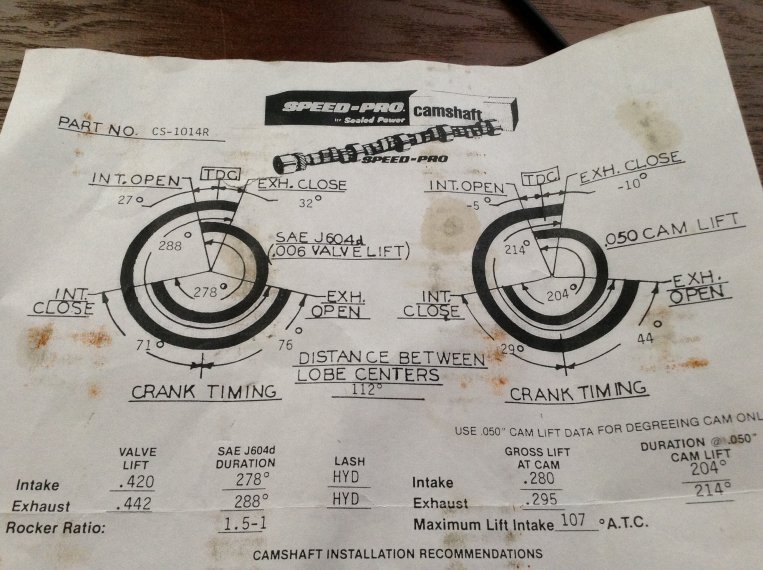

Thank you for the response. Yes I do have a heated oxygen sensor on the driver side collector. The sensor is for a 1994 chevy suburban 1500 w/350tbi. It has three wires on it; two white one black. One white is ground the other is 12v switched source and the black goes to factory o2 sensor wire. I was told that's how to wire it so I hope it's right. I don't know how to test if it is working or not. By the way there is no check engine lights. The cam specs are in the following image

Ok, thats maybe a step above stock, lobe separation of 112 is good, duration is a bit more than stock.
