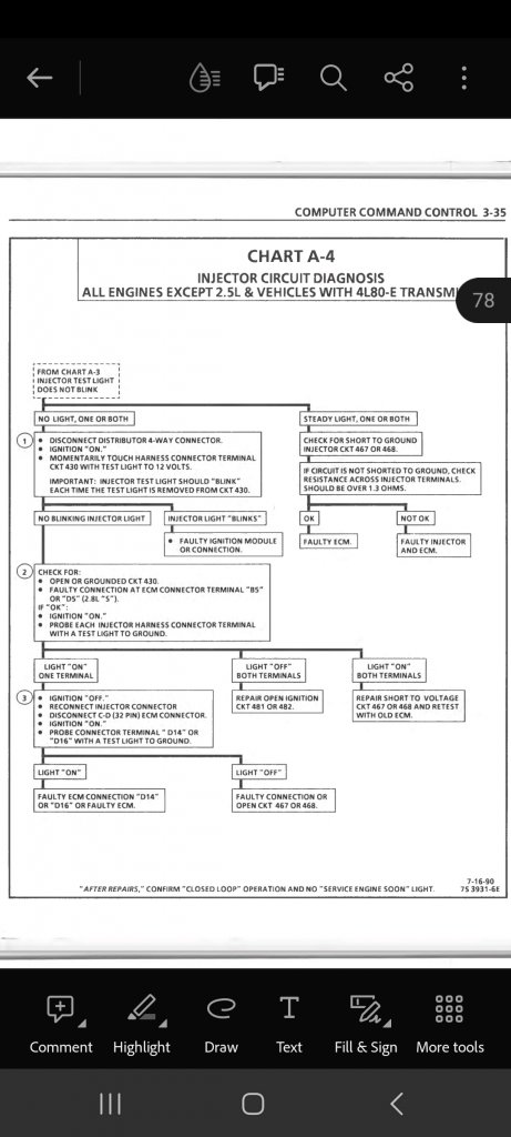

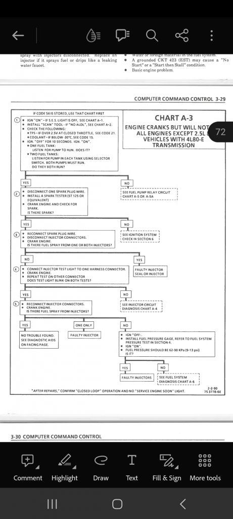

see attached

it's most likely the ignition control module under the distributor cap.

I can’t see much of that. I thought if the module failed you loose spark too?
I replaced that last year along with the dizzy.
I have another one I’ll try n swap it out.
