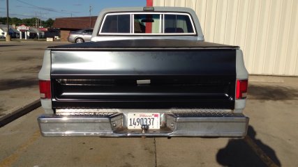

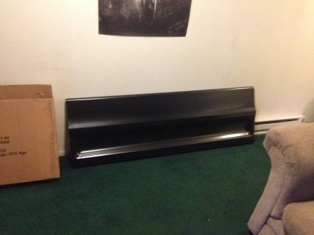

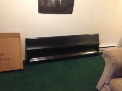

Bought a brand new tailgate and wanted to install it, bolts for the handle were frozen solid, so bought an impact tool and got two of the three out fully but the last one is about half way out but now spins freely! So I'm thinking the part where the screw goes through the handle has broken, anyone have a spare fat style tailgate handle sitting around? Seems all I can find are for newer tailgates. The handles are skinny and wider than mine!

Got mine apart and the new gate on! Just needs some slight modification or grinding for better fitment.
