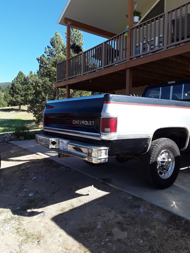

Josh is correct, the taper of an actual '87 tailgate is kind of wedge shaped where the trim panel goes, where the earlier years were more of a rolled, round recess. Pictured is my '81 & up tailgate

The 73-80 tailgate band pictured will not fit in an '81 & up tailgate. This picture is of an '81 and band.

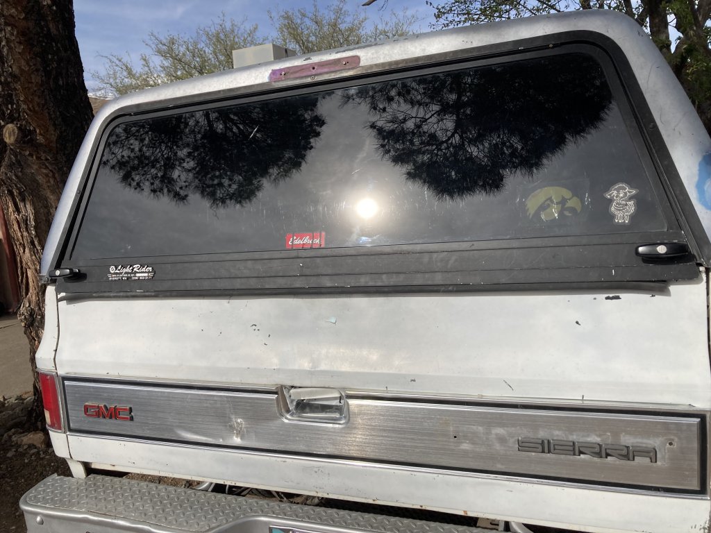

I used a long strip of masking tape mounted on the band, then measured where the edge of the band would be on the tailgate, laid the tape down and marked the holes. It's a Chevy gate but made my own GMC one
