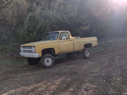

Am looking at new wheels for my 4" lifted K20.
I want 315/75/16 tires.
The wheels I'm looking at are 16 x 8 with a -6mm offset. I'm curious if that would be enough offset. Maybe I need more.
Any suggestions would be helpful

I ran some cheap Vision Soft 8 steel wheels with a -6 offset (4.25" backspace) wheels with 315/75R16 tires. Worked fine for me.
