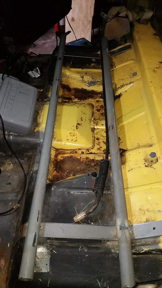

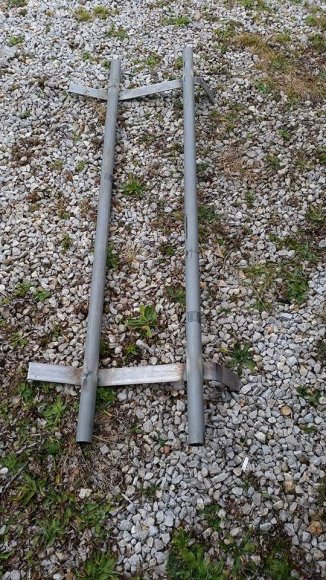

I know it might be to late but this is what I did for my seats out of a 96 dodge

Thanks!
