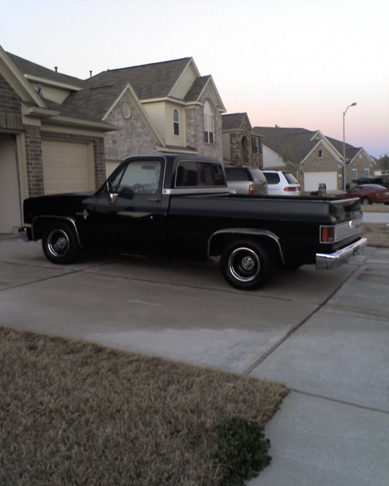

This is a prime example of why a spring drop of more than 2in-2.5in is not recommended. 95% of the time 3in of spring drop doesn't leave enough bolt to set the camber as well as the coil spring will usually fall over in the spring pocket whenever you lift the truck of the ground. Putting in longer bolts for alignment isn't as easy as it sounds, the stock alignment bolts are splined, so adding longer hex bolts don't fit like they should inside the concave bolt hole/pocket. If there are longer splined alignment bolts available, I am not aware of it.
The correct way to do a 3in drop is with a 3in drop spindle or 2.5in drop spindle with a 1in drop spring.
Another cheap and easy fix is to remove the 3in drop springs and cut 1 round off the bottom of your stock coil springs for a 2in-2.25in sping drop, you will be able to align it then. The pic below is lowered in the front with cut stock springs.
