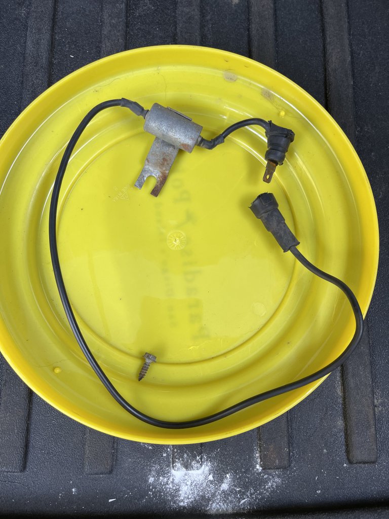

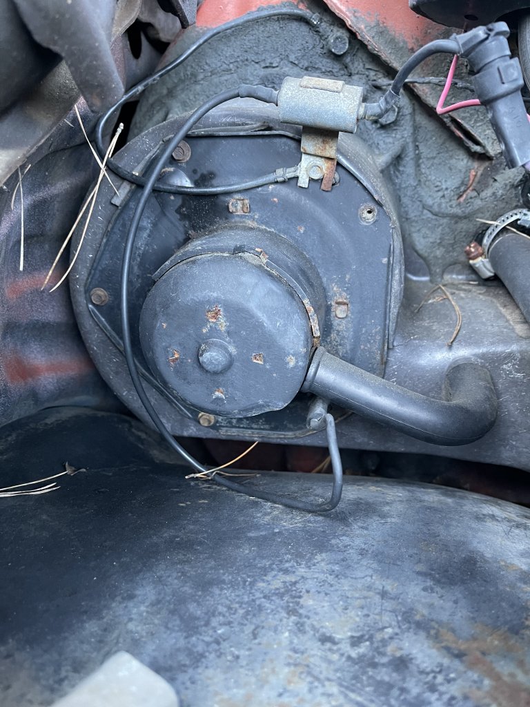

Hi all,
I was wondering if anyone can tell me where I can order a new wire for my AC/Heater blower motor?
The fan failed and the connections at the ends of the wires overheated and melted on the inside.
See pictures for what I am looking for.
Thanks in advance for your help!

What you are likely looking at and calling 'melted' is the same waterproofing that is at the bulkhead connector for the fuse box.
What you have there is the condenser that keeps the blower motor static from interferring with the radio.
Unplug the end from the blower motor and use a DMM or test light to find if you have ~12VDC with the key and fan ON.
If it actually has melted the connector(s) your best bet and cheapest is a junkyard.

Hi Snoots, the wire I have is too corroded. Any suggestions on where I can get a new one?
Thanks again for all your help!
