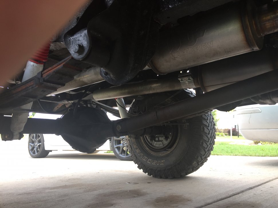

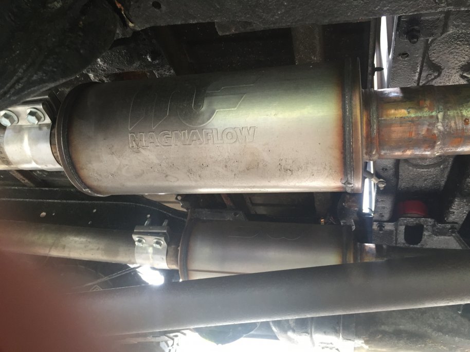

I recently did an LS swap into my 87 K10 Chevy short bed. It's a 5.3 LM7 out of a 99 silverado.
I have Shoenfield long tube headers with 3" collector, 3" stainless ball flange into Magnaflow 12619 round straight through 3" mufflers. 3" stainless pipe fully tig welded save for the ball flange. If your standing at the door or laying underneath the truck there are no audible leaks, but when your standing behind it at idle it sounds like there is a leak coming out of the pipes. It has a low deep tone/rumble but there is a hiss/exhaust leak type sound mixed in as well and I cannot figure why. At WFO it has a good aggressive sound with a touch of crackle but I believe an H or X pipe will solve it. It has potential to sound awesome but it seams like I missed something with this setup. If anyone has any thoughts PLEASE share!!
Thanks Yall!!
Sammy
