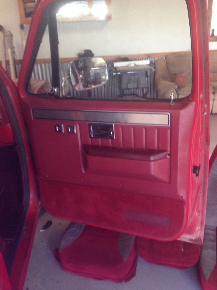

Mine are LMC, I would rate them 8/10.

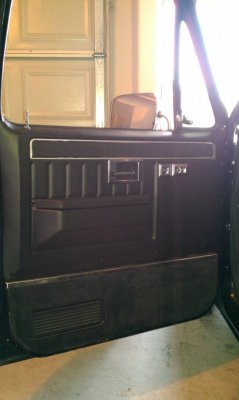

Mine are lmc, bought the billet without holes for door pull straps. I like them. You have to cut out the panel for the chrome trim piece that goes around your open handle and of course for your window handle or switches.

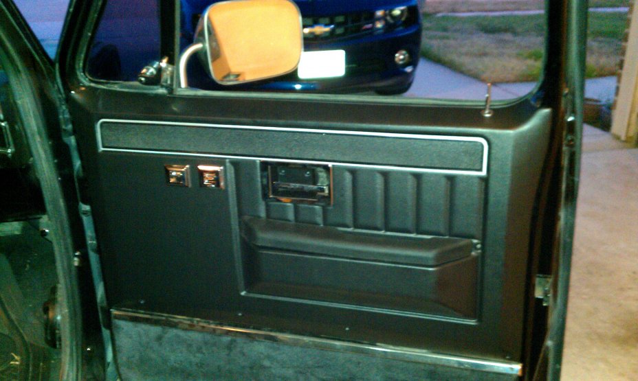

Here is a OEM that had a huge crack at the top and bunch of dead plastic. I am using it as a test panel. I repaired the crack and filled the door pocket mounting holes. Sanded off all the dead plastic and sprayed it with Rust-Oleum truck bed coating. Sanded that until it had a texture I liked. Now spraying it with vinyl dye to find a match to my Corvette torch red interior.

Nice job!
That is really the look I'm after. Stock minus the pull straps. Looks good!

Thanks, I feel the same way. I love the stock look but the pull straps stretch and I always seem to break the little chrome covers on the ends.
