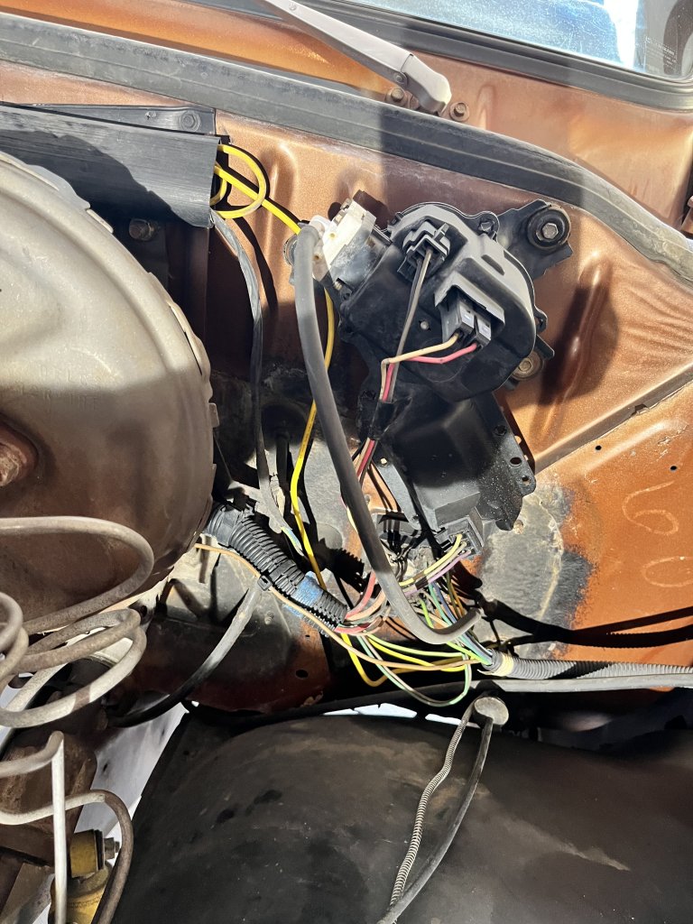

I’m at the end of the road with this issue. I recently replaced the neutral safety switch due to my 1980 C10 not starting 100% of the time. Well that wasn’t it, as I discovered it was the ignition switch. Replaced it and it started once and the lock cylinder wouldn’t go back to the lock position and no couldn’t get the key out.
Well, I tore into the column and fixed the rack and sector, got everything back in place lined up and followed the instructions with the new ignition switch and neutral safety. Turned the key to the in position, got the buzzer, air circulation etc., but now start. I put the key in accessory mode and nothing. All I want is the truck to start as it was driving perfect prior.
Any help or recommendation on where to go next? It’s a 1980 C10 Custom Deluxe and had tilt steering put in at some point by the original owner.

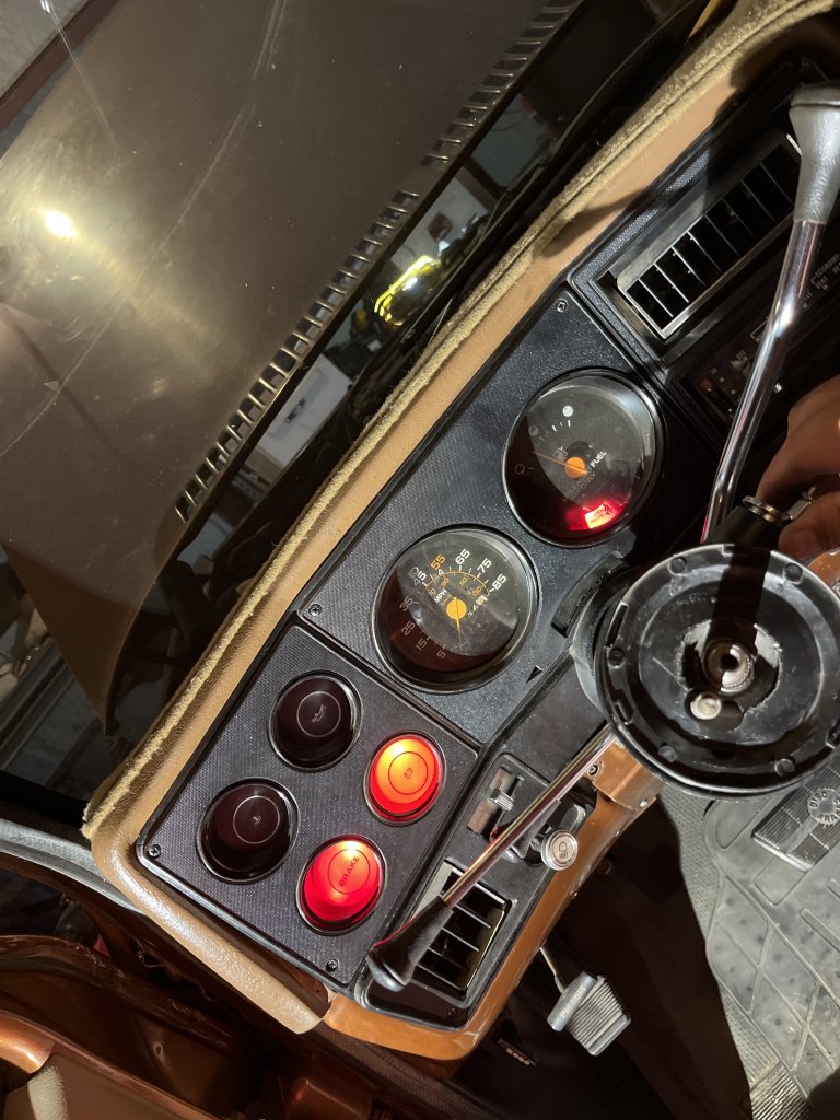

All I get is the buzz from the dash and the air circulating.

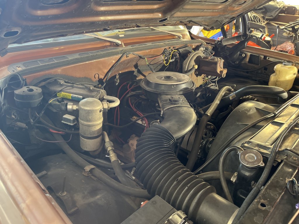

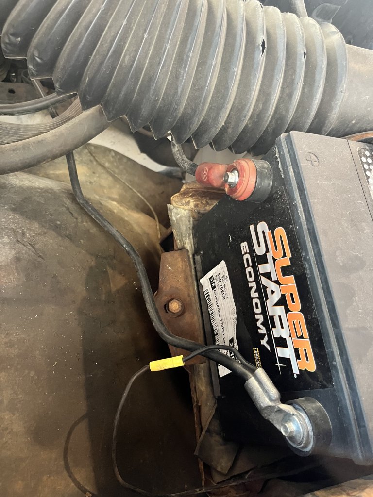

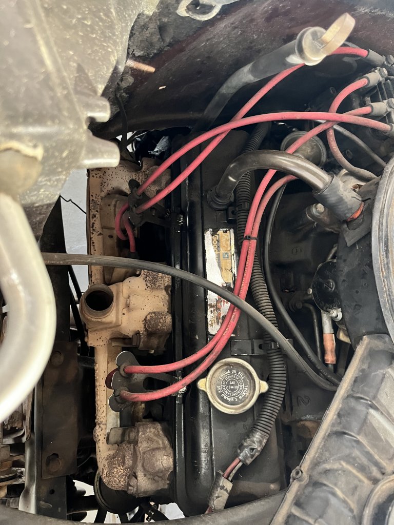

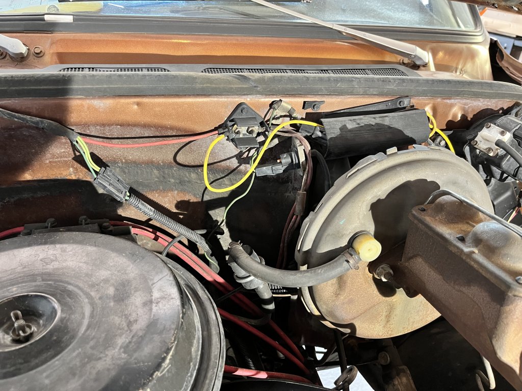

is your Battery to engine ground good? Is your power cable to the starter good? Ive both zapped the power cable in half(Was rigged bad) and about started a bbq with the ground cable from my fender to my battery when the one from the engine was very corroded and barely connected to the battery. But these were not stock cables but jury rigged solutions by my gpa. Show us under hood if you could?
See the cable with wrap where it gets oddly "big" Thats where I lugged a suitable cable I had onto the lug that is on my power cable to my starter. frankly I just never asked(hes dead anyway) but ill eventually fix it to something more future proof. The heat shield on the first photo is what is probably the original hot cable id say and then the wires for the starter etc.
Here is my ground cable, a new one which is just a auto store lug-lug cable with a marine post on the battery to accept the lug and then the bracket for the alt to take the cable. The connection on the intake and the (Water pump? Block? Head?) that the bracket uses were cleaned up and the bolts to to ensure a ground path and the alt case ears too. The starter grounds through the engine through that bracket to the battery. Realistically, that wasnt smart, which is why newer vehicles either run a ground to the starter or they ground the block so you dont have the heads, intake, then bracket to corrode or cause bottle necks etc.
The engine should have some straps to the firewall from the heads, and the fender should be grounded to the frame (you can see in my pic earlier)

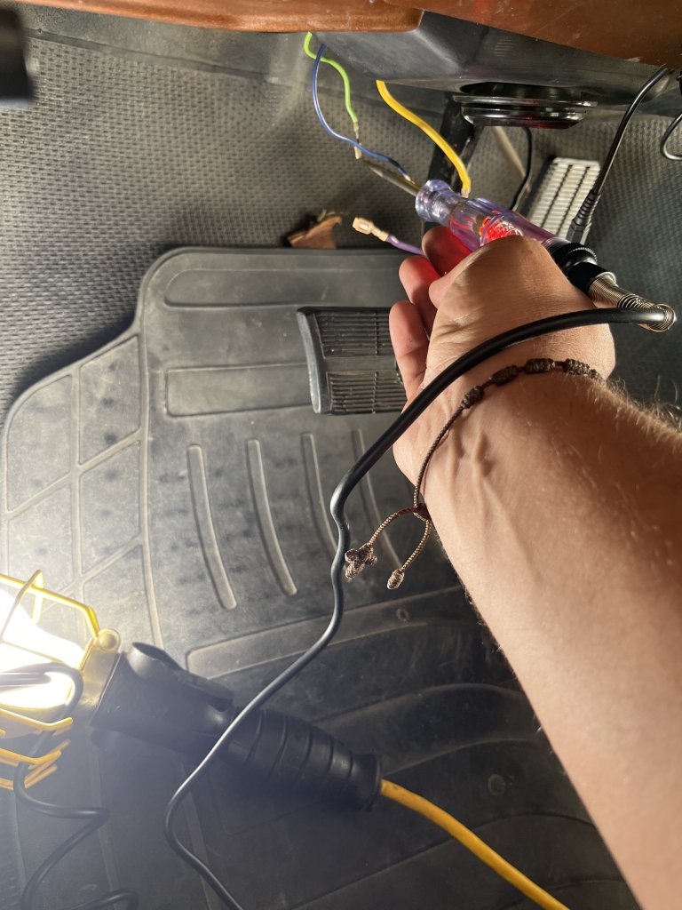

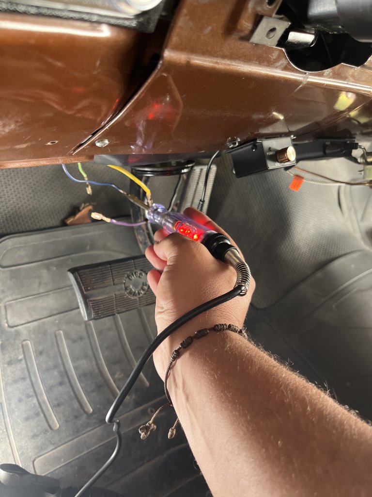

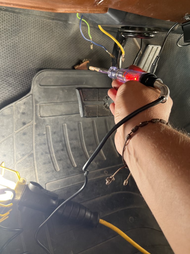

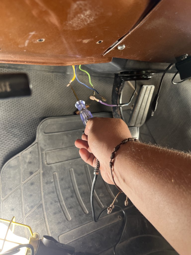

In the pictures, I have power from everything but the yellow. On the neutral safety switch, only the yellow and purple have been connected.
The blue and green have been hanging. When the green touched the blue before taking the picture the truck tried to kick over.
I do know for a fact the green hasn t been connected to anything since Ive had it.
Yellow is the only one with no power.
Thoughts?
Thoughts?
on my manual truck yellow goes to the clutch safety, and the purple wire is on it too, thats my interlock. I have a stock 1980 column. So this is a pic that I think may be a 1980 as well, did a google foir it
The colors match and are in a connector that go on blade terminals looks like maybe someone put female spades on
I only found this diagram(which doesnt show the termination of the circuits) but the colors match that too

I just noticed your battery cable connections. Yeah those arent secure looking, the one on the positive looks like its missing something in that stack like the right bolt or spacer. I would peel that rubber off the lug and see if its corroded. Then on your other one, I cant tell if thats a side post lug to begin with. do you have a top post battery you could use? alternative, I suggest getting some marine terminals and side post adapters then making it connect by stacking the lugs of the cables on the marine terminal then connecting with the "normal" way, thats just me tho. if you have a top post or want to make them work as side, you can too. They sell the proper bolts for the side post at the store
