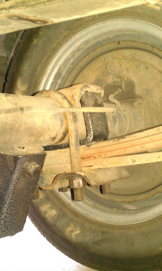

This is my 82 before I tubbed it. 5in flip with no c-notch. You need at least 2in minimum clearance for suspension travel, as you can see I had 3.5in at ride height. My 78 daily driver has a flip kit and no c-notch with about 2.5in clearance for susp travel.

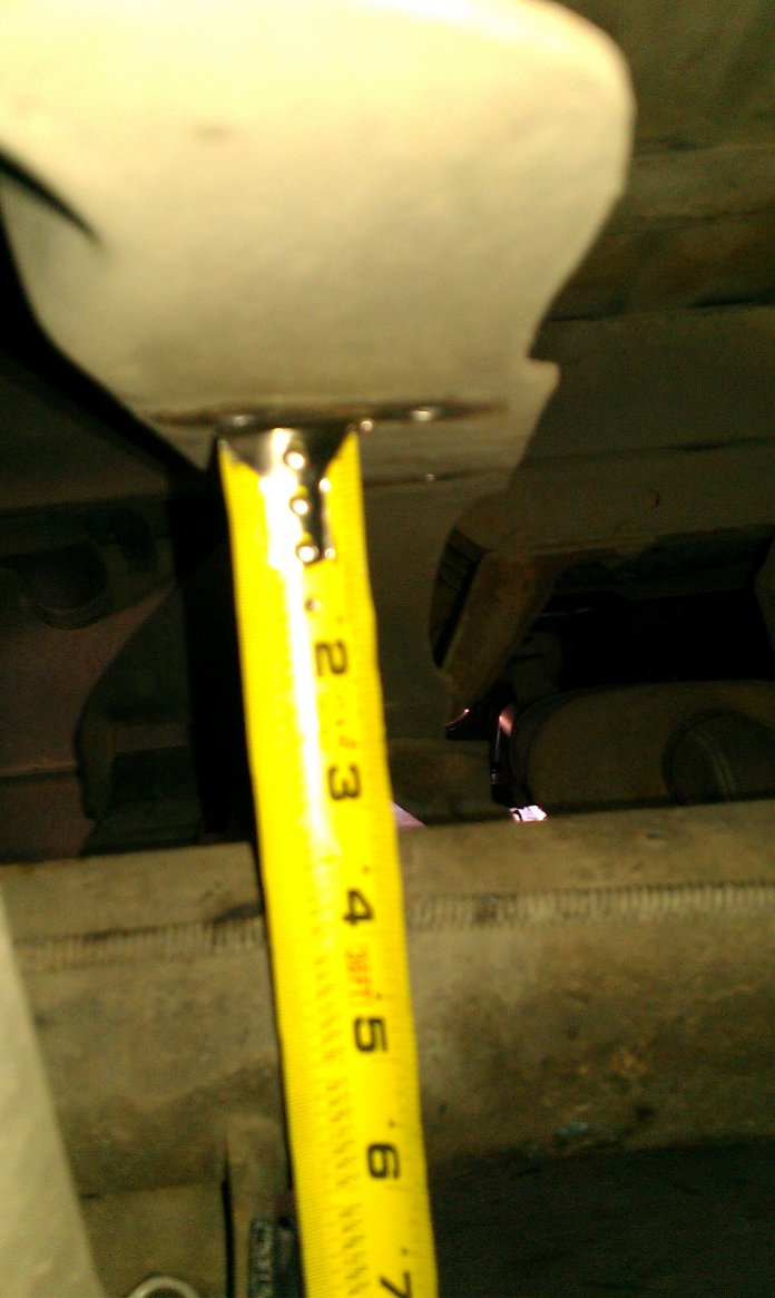

Also, is there a way to measure the rear now to make sure I wont have to notch the frame? For example, can I measure from the top of the axle to the bottom of the frame now to get a idea of where the axle will be with the 5" flip?

You need 5.25in from the top of the leaf spring to the bottom of the frame. To break it down that is 2in suspension travel, 3in for the axle tube, and 1/4in for the flip bracket. I stated this in the past post that this is where you need to measure. More than 5.25in no notch is needed, less than 5.25in I would recommend a notch. The axle tube will sit 3.25in above the top of the leaf spring. If this isnt clear, get the measurement and I can tell you if you need a notch.

OK, im good to go... from the top of the spring to the bottom of the frame, is 5 3/4"'s.
