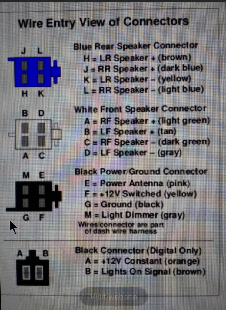

Gray is dash lamps. If the new radio has a wire labeled illumination or dimmer, that’s the wire you want to trigger the radio to dim the display.
This is a pinout for a stock GM radio. Black is ground. Orange is constant power. Yellow is ignition power. Brown is taillight (used on some radios for bscklighting)
Hope that helps.

The orange wire from the cigarette lighter worked perfectly when connected, and yes, I did blow a fuse in the process.
Case closed.

black is GND-yellow ignition power and grey dimer light....you need orange constant positive to have it work ;)

@Iamsoocluess what are you asking? I’m confused? If it’s stereo power we answered you in another post you made.
Yellow from truck is power, black from truck is ground and grey from truck is the back lighting for the radio.
