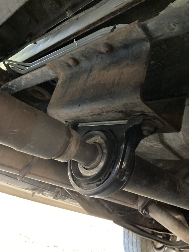

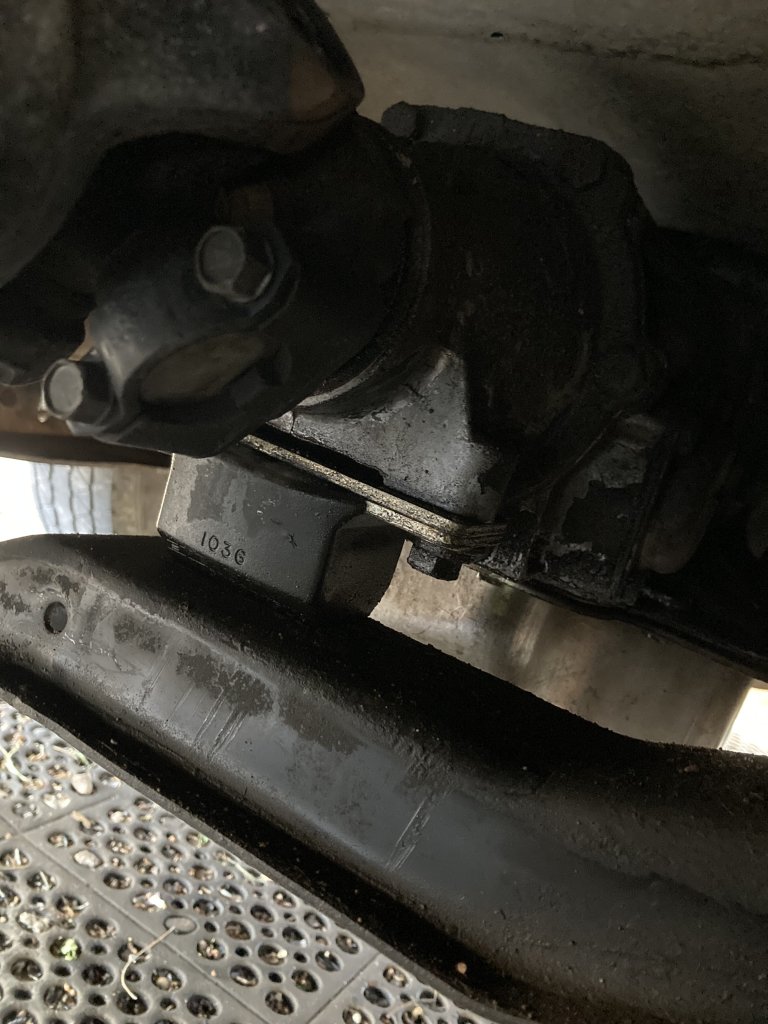

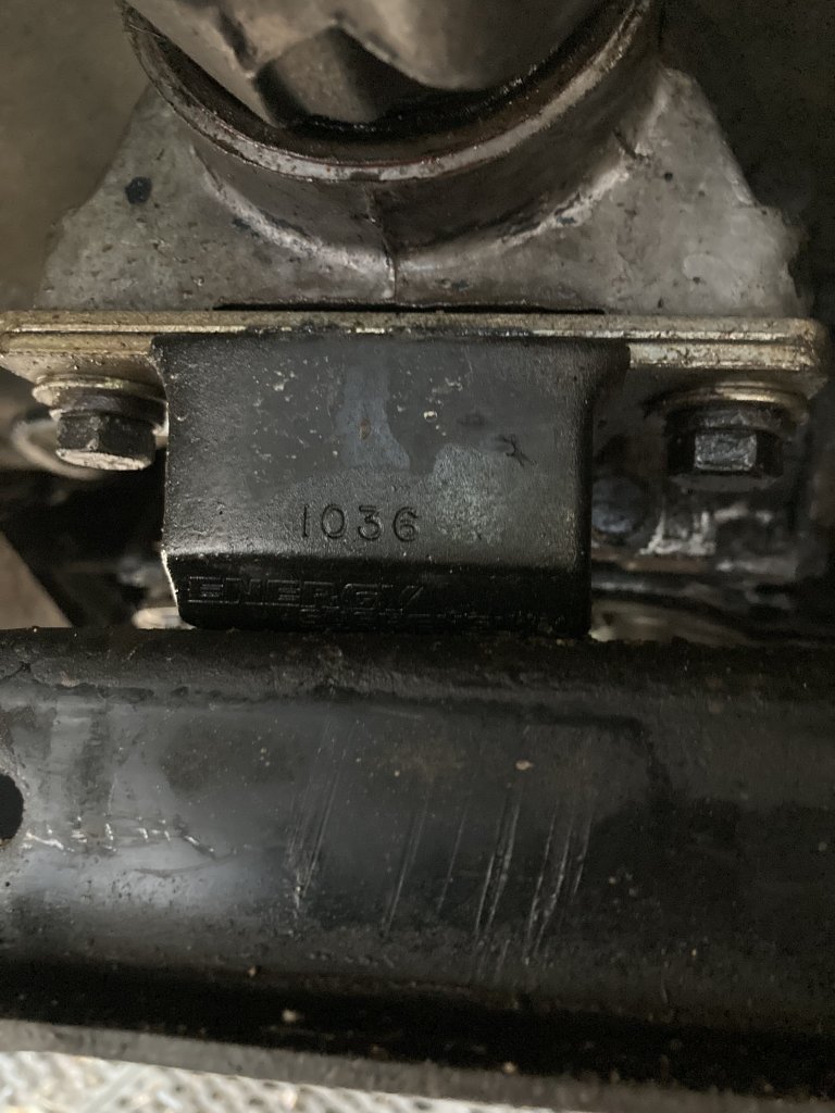

This is my 84 C20, long bed. Hopefully you can see the U shape channel that the carrier bearing mounts to. I also added some pics of my transmission mount. I had the round one on it originally, but the new round one wouldn't tighten up, so I went with the rectangular unit. I think I got it from Rock Auto. Sorry they are on the dark side.

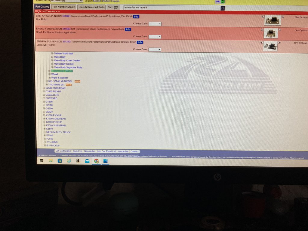

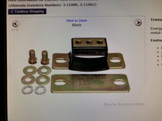

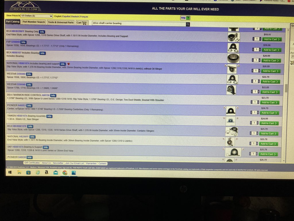

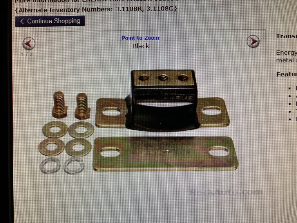

Here's some images from Rock Auto. The last pic is the transmission mount I used. Hope these help.

Thanks. That is the transmission mount that I have. The 4WD trans crossmember is quite a bit different so I had to make a spacer to go between the bottom of this mount and the 4WD trans crossmember.

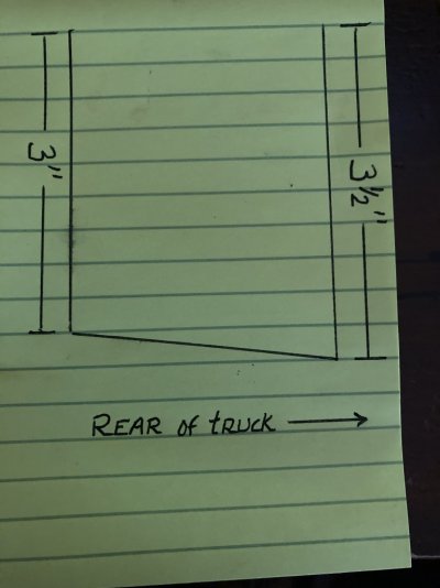

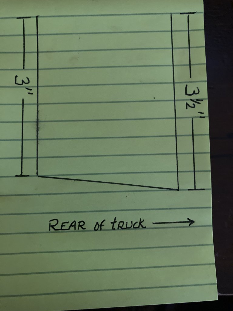

Thanks for all the photos. Can you tell me an approximate height of that U shaped bracket that is riveted to the crossmember of the truck's frame? I.E. the U shaped bracket that the center bearing bolts to. I am trying to figure out the angle that the driveshaft should be at in the truck. It looks like it is a different height in the front of the bracket versus the rear of the bracket to account for the slope of the driveshaft.

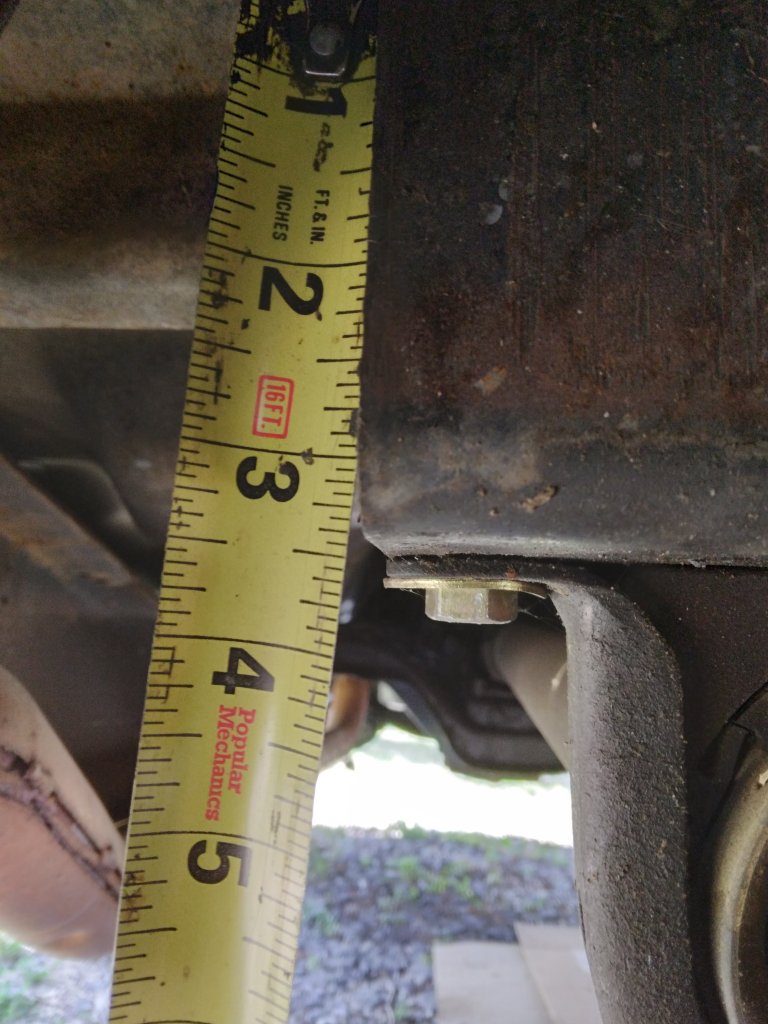

Pic of the front measurement of the midship bearing bracket depth.
Also note that the driveshaft is 3 piece, with a shorty section behind the mid bearing followed with the rear longer shaft to the differential. The shorty allows for the deeper rear section drop.

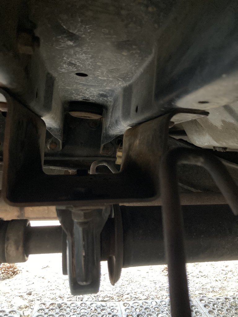

Better pic of the rear side of the bracket.

So let me see if I am understanding this correctly. It looks like from these pictures that this U shaped bracket is about 4 inches in width (front to back) and at the back it is 3.375 inches deep and 3 inches deep at the front. Is that correct?

Looking at the U bracket, it's 3.5" on the back side, and 3" in the front, as you said to account for the angle of the driveshaft. Hope this drawing helps.

I just double checked my U bracket (1985 c30) which is a slight bit shorter on the the back side than 84GMCSierra's '84. Mine is 3.375 as you said, Lotus907. Bracket steel is 0.375 thickness,
and it is 5 inches in width (front to back), and 8 inches across (side to side), with front and rear flanges 1 inch wide each.
