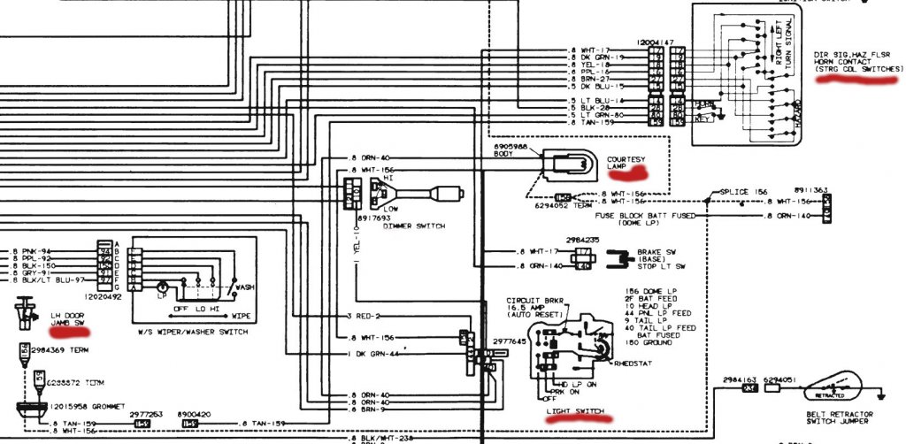

Maybe this will help. I would start by checking TAN-159 wire. Especially since you think it started after steering column swap. Double check connection at column. (updated pic- accidentally highlighted dimmer instead of light switch)

I'm learning as I go.. If I'm looking at the diagram correctly. TAN-159 is your key alarm (& you said it is working) If I understand it correctly, that means the door switch appears to be grounding like it should- So that leaves WHT- 156 running from the door switch to the light(s) is probably the problem. Hopefully someone who is more knowledgeable can help.
better diagram from AuroraGirl in earlier post- https://www.gmsquarebody.com/threads/confusing-door-jamb-switch.37191/

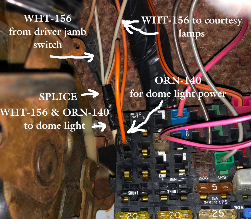

My bet is bad connection with door jamb switch. The WHT-156 connects with the door switch and splices with another WHT-156 wire that runs to the courtesy lights & dome light. I figure your problem is somewhere from the jamb switch to the splice. After reading this post I decided to fix my driver door jamb switch-which hasn't work for years. I had the part and meant to change it a year ago. I unscrewed it and started to pull it from the body, but the connections won't fit through the hole.:( I didn't feel like having to fish for wires, so i just screwed the old one back for now. Upside is dome & courtesy lamps came on when I grounded the connections trying to get it through the hole.

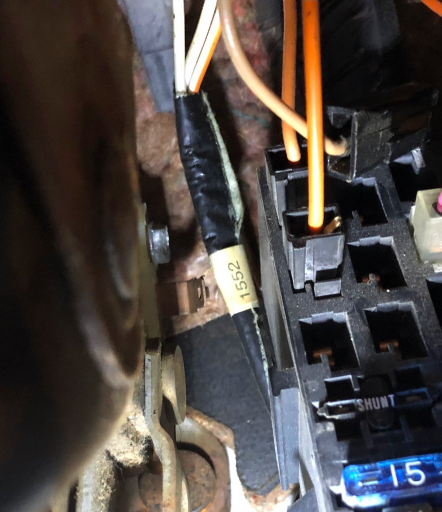

Since I was under my dash, I went ahead and took some pics that might help. These are from 85 K10.
