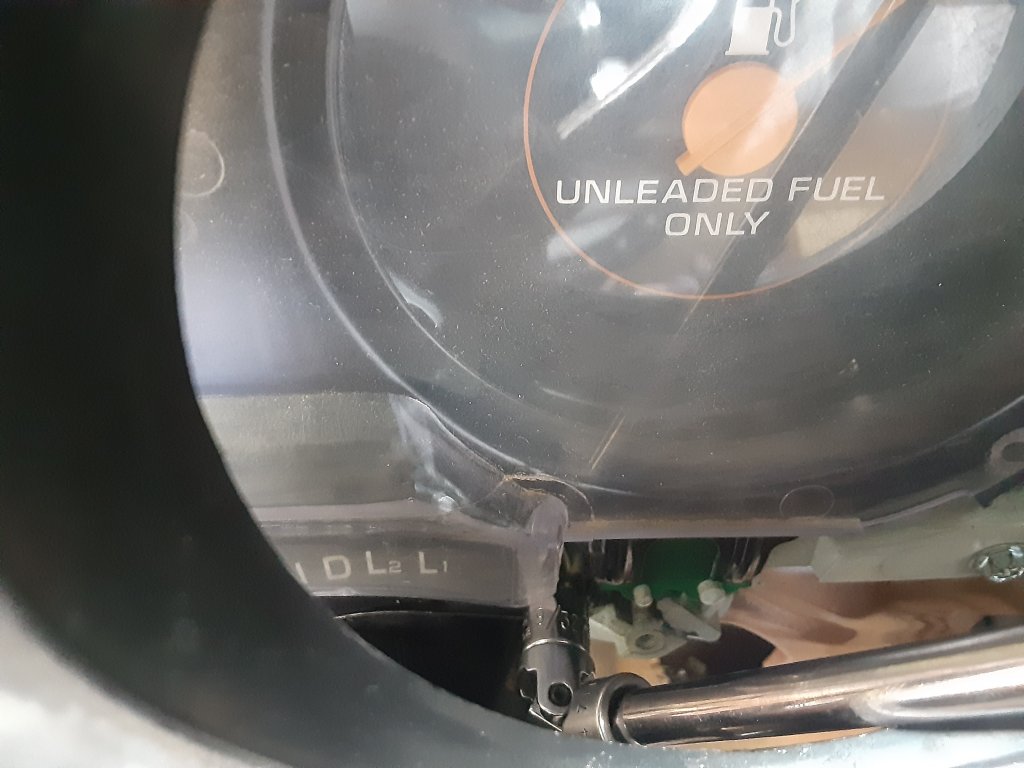

I just grabbed the thing (gear indicator) and went on out there and put the thing in. I got tired of worrying about how hard it was going to be since I couldn't get the inst. panel out as far as it needed to be. But I managed to get the panel out pretty far since I don't have my fuel pressure gauge in yet which would have a braided hose attached to it further restricting how far I could pull the panel out. I got the left screw in easy but I knew the right screw was going to take awhile. It wasn't as bad as I thought since I was able to pull the panel out far enough without having to drop the steering column down by taking out those two big bolts holding it up against the column support under the dash.
But here's the pic I took of the part about getting the little cable through the part for it, a guide of some sort made on the lower corner right there of the White plastic box behind the inst. panel, so the cable has a smooth downward pull on it for the needle to line up correctly with the trans. gear.

Pic's.
Here is the thing the cable needs to go into. You can see that the cable has to make a "v" shaped bend to get into this "cable guide". And there are two cables. I've done this a few times and have found it easier to work one cable into the guide and then the next.
One cable goes in with the help of a small flat tip screw driver, or you can get it in with your finger tip. You can feel it slip in. The guide is made this way so the cable will have something it can glide along and that won't let it just be free to get caught in the steering column. So it's got that "v" shape it would never be able to come out of itself.
Second cable is in.
Final step in the install is to push the clip over the slot in the lower housing of the column and put the screw in. You can just make out the top of the slot above the clip. Snug the screw down after looking at the face of the indicator and approximate where it needs to be with the vehicle in park pointing at "P". You'll probably change exactly where the needle goes, so this first placement is a starting place.
You can just see the end of the cable guide. Just follow the end of the cable where it's attached to the arm of the clip as it goes over the guide, and you can see the two cables going back toward the pointer.

Checking adjustment.
This is the position of my pointer after the clip was adjusted. It's just off the "P".
In "R" reverse it was right on.
And "D" drive it was right on after it was in gear. Now, I hope it doesn't hang up like it was doing which was the whole reason I had to take it out in the first place. We'll see. It was doing alright while parked in the driveway, but it's on the street that counts, on a hot Summer day, or a freezing a** Winter day. You know, metal properties change with temperature. And this indicator wasn't none to tight to begin with. Maybe loose is better, but I never had a problem with my factory one hanging up.
