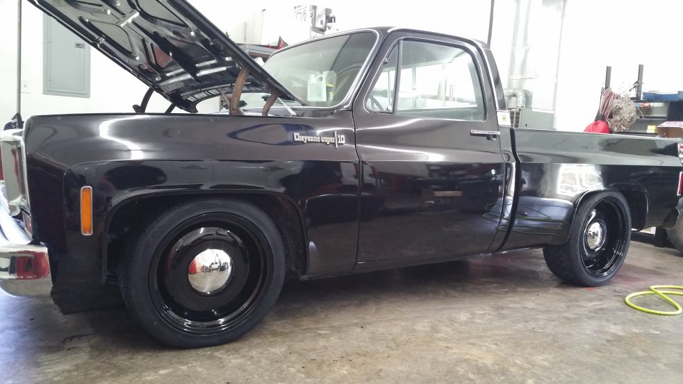

I have lowered my truck and my tires are hitting the top of my inner fenders. I run a 20.8.5 with spendels 1 inch coils and upper and lower controls arms from cpp. Thanks yall!!

This is a picture of my truck..
