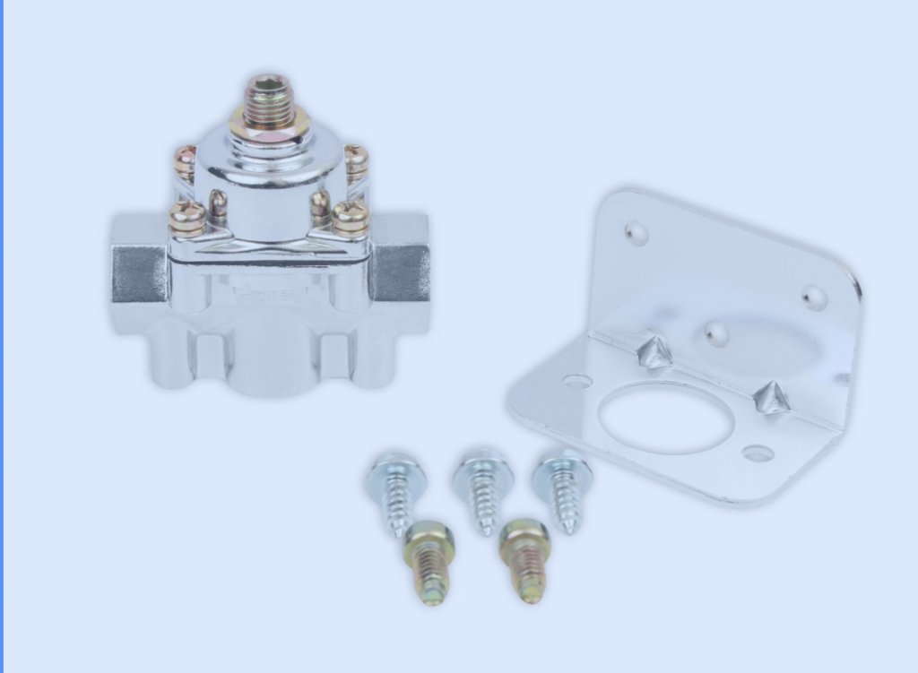

Hi Ricko1966 thank you for the info. I have a new Holley FPR in my tool box that I was thinking about trying it’s model Holley 12-804 what would be your opinion on this specific type of fuel pressure regulator.

You need a fuel pressure regulator with return and it has to be matched to the pressure output of your fuel pump. The Holley 12-804 has a maximum inlet pressure of 7 psi.
The in tank fuel pump puts out ~ 60 psi .
This could work for your application:
https://www.summitracing.com/parts/fsy-fpr-1001

I didnt bother answering because by the time I saw this Ali had given you proper advice. The regulator you have is a deadhead regulator. It just prevents flow through to regulate pressure on the outlet side, but restricting flow also restricts volume and can put serious dead head pressure on the pump. Not good for pumps. A bypass regulator allows full volume but allows excess fuel to pass through the regulator reducing pressure at the carb. Also since fuel is constantly moving instead of just coming to a point and stopping or slowing drastically, the fuel and pump stay cooler.

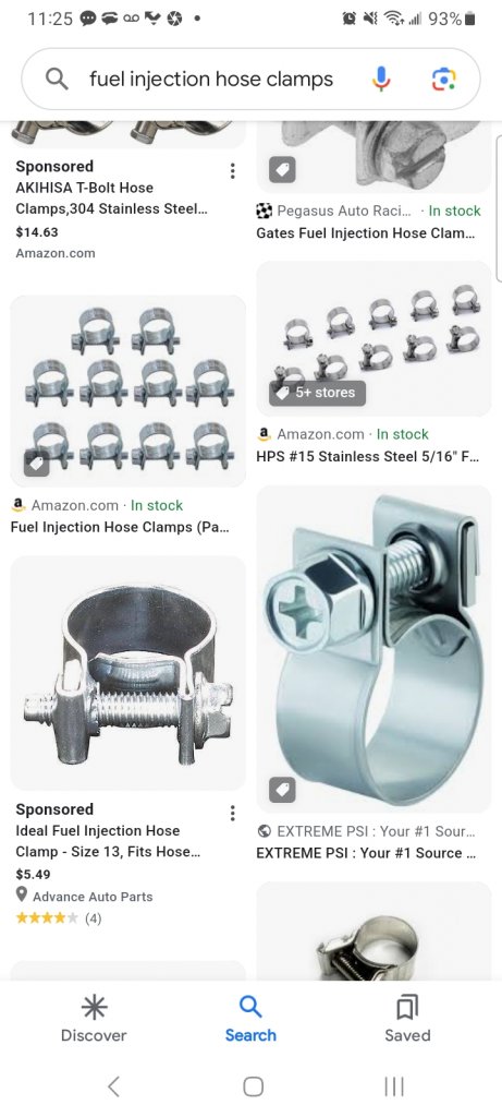

Hi guys yesterday was payday so I ordered the correct regulator. I will update how the installation goes. Again I appreciate every one of you that took the time to chime in and help me out.
By sure to use fuel injection hose and clamps
