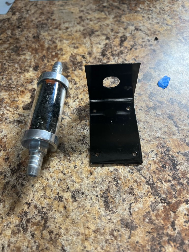

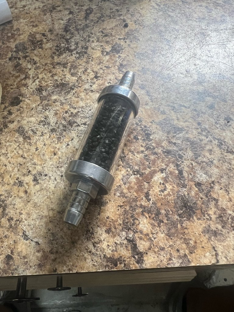

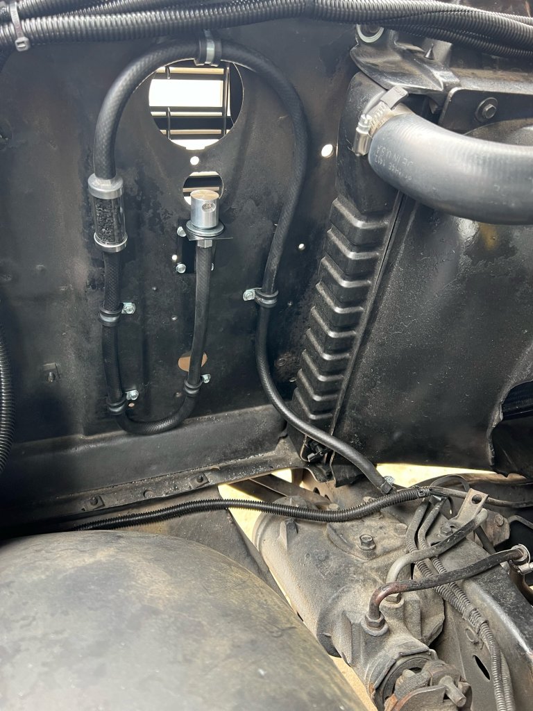

agree with all above, needs a vent. We had a similar issue with a strong gas smell around the truck all the time. Had a vented cap at the time (PO). We finally found the vent tube was cut and plugged (PO) by the radiator support and lower radiator hose. Could not find a factory charcole filter at the time so we made one with a fuel filter housing and a fuel tank vent. Cap is non vented now. Has been perfect ever since.
