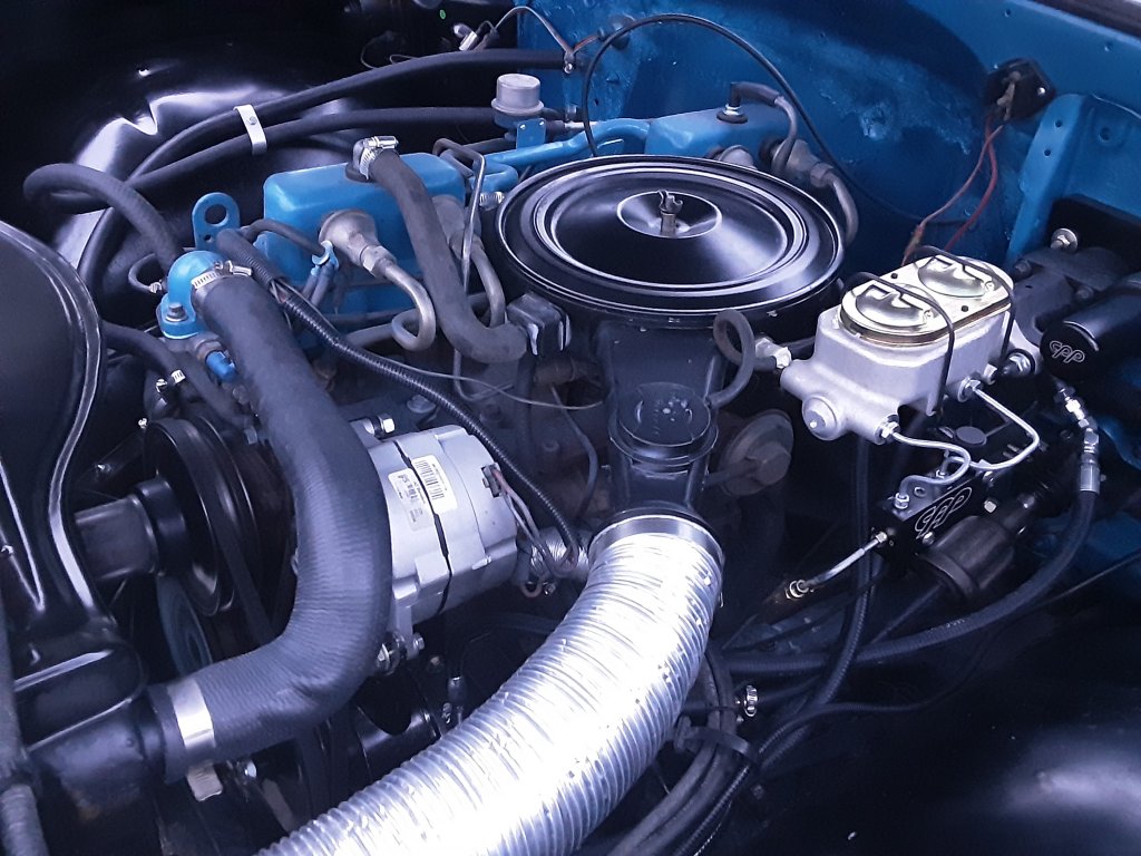

Thanks for the heater blower history lesson. It will now run forever. I did find a wiring diagram in my 1979 service manual. A lot easier to read than the reprinted diagrams I bought online. Unfortunately, first try with heater hoses connected, I'll be changing the heater core.

Thanks. The local high-school auto class had painted it with school bus paint. I sanded to metal and primed with Eastwood roll on primer. Ended up spraying, too much roller stipple.
