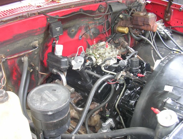

I installed a new blower motor, hooked up all the cables correctly on the interior. The heater flap is working as it should. Open or closed. By the truck will not blow hot air!
the previous owner put a new radiator in and the top outlet is capped on the passenger side. I have hoses running to my intake and the other one to my water pump. I thought one hose was supposed to go to the radiator?
What's the correct hose hook up? Pictures would be nice also.

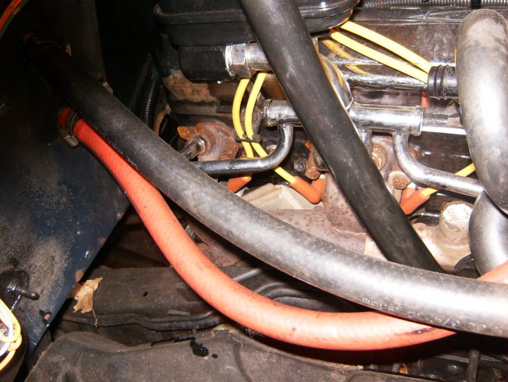

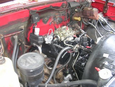

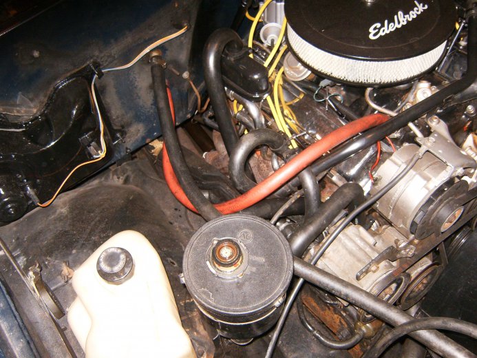

Flow through the core is in from the bottom, up through the coils and out the top.
The bottom hose is the higher pressure hose and connects to the nipple on the intake manifold.
The return to the engine is the outlet from the top of the core and can connect to either the tapped connection on the water pump or the nipple on the top of the RH side of the radiator. Schematically speaking, in the system the are in the same run of pipe.
Inlet hose is the smaller (9/16"?) of the two - red in the image below.
Outlet is 3/4" and is shown as black below.
