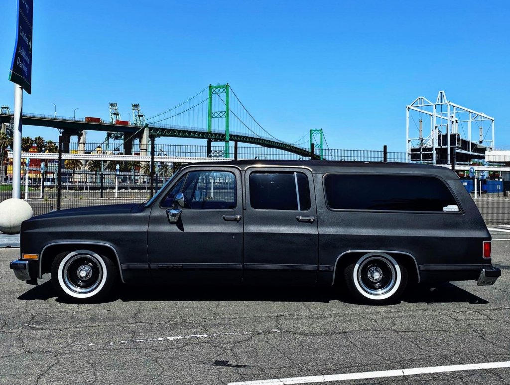

I’ve had that issue for some time now I even bought a set of Used leaf spring from another 90 Suburban thinking that they would be less of a sag on them (bad idea sagged even more) after I did the original flip about a year ago it was riding nice except it was hitting the frame so I had it c-notched worked for a while then started to sag. I’ve given up on the flip it’s to the point where it scrapes every driveway hit the gas tank on every parking bump stop. I’ve decided to take the flip off put out the way it was and add some lowering shackles, should of did that from the beginning. SMH …..
