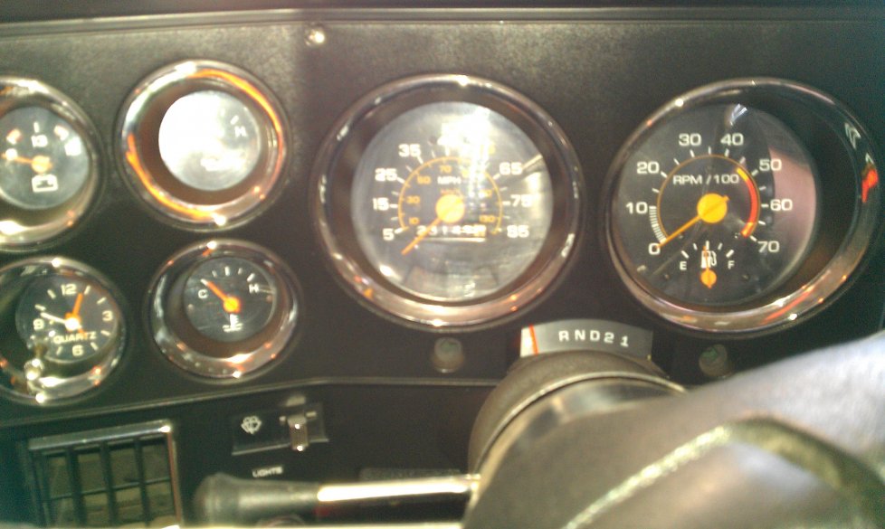

This is what it looks like installed in my truck.

That looks very nice and looks stock which is what I prefer. How was the install fairly easy?
