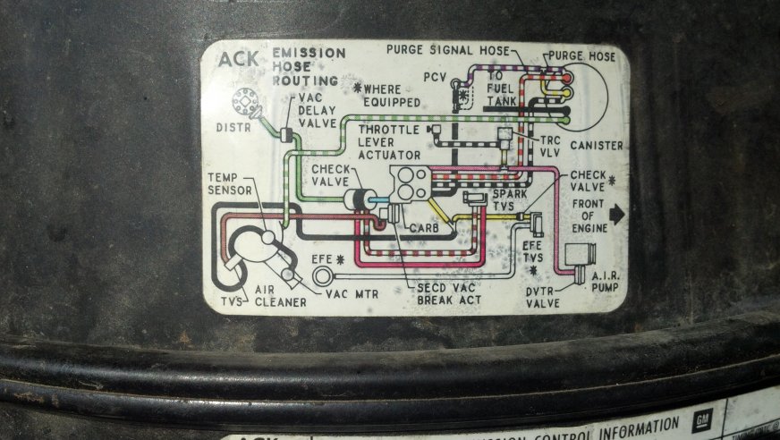

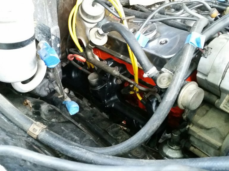

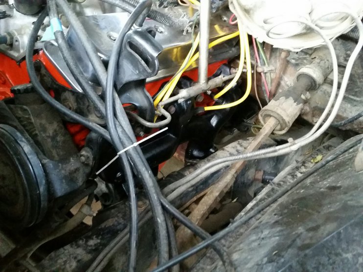

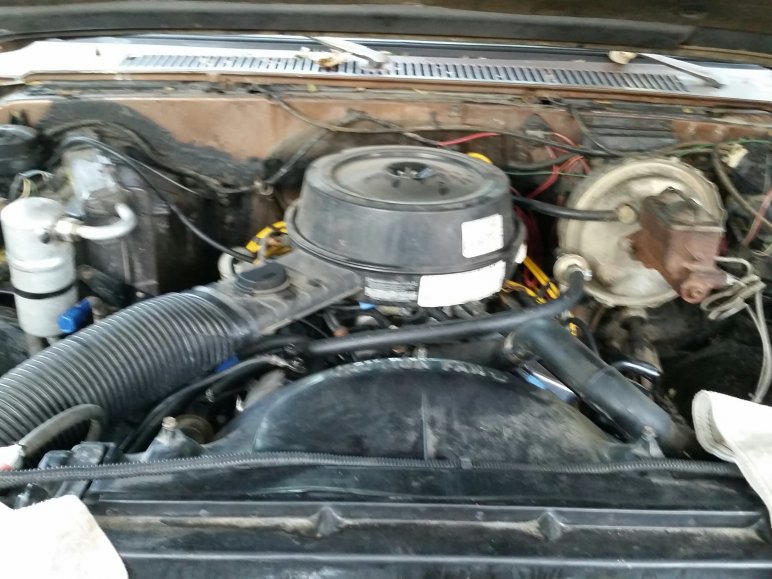

Hey all,
I think I have an opposite thread of the normal trend here.. hah. I searched around for emissions and SMOG information and whatnot, but I'm finding a lot of "removal" information and "what good are these parts" types of threads but not so much details on what parts they are for the middle years.
So here's the issue I have.. I have a 77 Arizona-built K10 with a 350, headers, all SMOG Emissions stuff removed, etc.. It's a good motor.
But I need to get it converted over to California SMOG legal emissions setup so I can get it re-registered here and legal to drive on our roads.
So I guess my overall question would be; what is the required SMOG Emissions gear for a normal 1977 350 (what items do most of y'all remove?) and what do I need to track down and put on to this thing to pass the tests?
Thanks for any help or links towards help I can get here.
